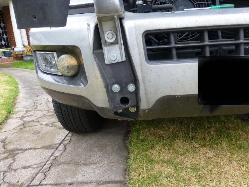

    I need to remove the sovereign bar from a 2007 120 GXL so I can replace missing screw from driver's side head lamp assembly
    having a look I'm guessing the easiest method is
    - have a mate handy....
    - Remove the screws holding the inner guard linings in place
    - Disconnect the lights (indicator, parking and fog)
    - Remove the 8 bolts (4 each side) behind the plastic covers
    Have I missed anything?
    Is there a specific torque the bolts need to be when I put it back on?
    Will also be fixing the dodgy wiring Toyota implemented when they fitted the bar & giving it a clean

    Had a another look and there's another 2 braces attached. So take it off from the chassis?
    cheers,
    Steve
      That sounds like about it. take the 8 bolts out and the 2 at the sides, loosen the other spport bars to get movement to slip it off
      Do them up tight! has it had the recall done? check that too.
      if the side support bars are round it has not if they are flat it would have been done.
        thanks - recall has been done.

            I have the updated instructions written for the recalled brackets.
              Gday stevemac

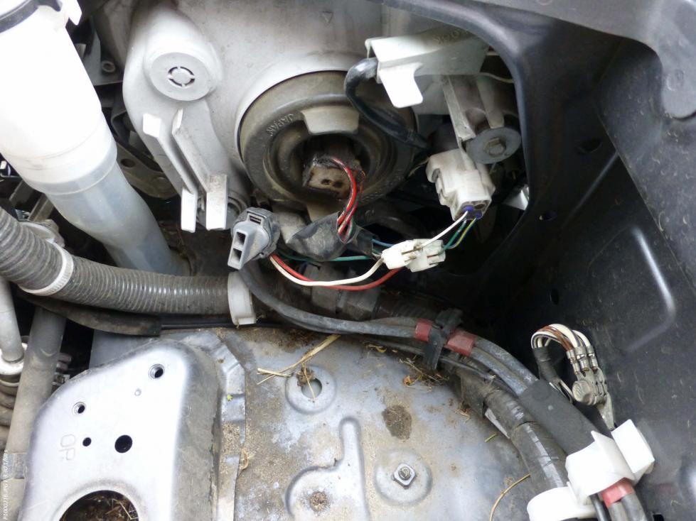

              Am just letting you know that you don't have to pull the sovereign bar off to fit a missing screw for the drivers side headlight as i have already removed my drivers side headlight to fit my home made catch can and didn't touch the bull bar at all which also means that you wont have to mess with the parker/indicator lights either.
              If you want i can email the detailed pics on how to do it without touching the bull bar!

                  Gday stevemac
                  Sent the pics.
                    hi Skywalkerrun,
                    Job done. Thanks for making it a lot easier.
