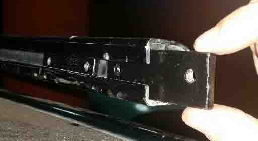

              I just took the whole roof rail off on the copilot side so I could see everything. Took a while but got the TOR 30 screws out, inserted my 2 flat metal pieces inside the rail, and reinstalled everything. I took off both feet from the rail even though I didn't need to to get those other 2 TOR 30 nuts cleaned up. Did I need to put anything on the main bolts (12mm) that secure the rail feet to the roof?
              On the pilot side I just removed out the foot securing bolts on the front foot and then un screwed the TOR 30 nuts. Tough job as it's underneath and low clearance, almost to the point that the TOR wrench couldn't fit as the screw exiting reduced the clearance and they didn't turn easy with the fingers.
              Some observations/questions:
              - Here's a picture of the inserts, one inside and the other going in. Are they OK to replace your M8 unistrut?
              - I sprayed the flat metal inserts with WD-40 for some added rust protection. Was that pointless?
              - I cleaned the TOR30 nuts with WD-40 and then reinserted. Now wondering if I was just going wd40 crazy. Is that OK?
              - the part of the front feet that blocks the entrance to the rail is much bigger than on the back. My 2.5cm height inserts couldn't pass either but there is much more clearance at the back foot, probably to given that stopping causes much more unintended moving than accelerating. I would guess your photo is from the back as the front almost blocks half of the opening.
