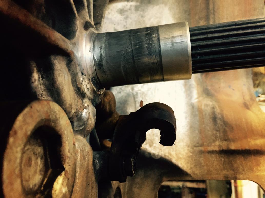

    I have a 2009 120 series D4D with a 6sp manual gearbox. I got my clutch replaced in Mar 2014 and after 12 months the release bearing (thrust bearing) started making a noise.
    I got the clutch replaced and it was noted the snout on the end of the gearbox had a worn groove in it where the release bearing slides up and down on (see photo)
    So I have three questions:
    1. Is this a common problem?
    2. What is the likely cause/s? (I have my theories) and
    3. What have others done to prevent this?
    Now I spoke to the Roo and he put me on to:
    BHSS-TBS Brake & Steering Remanufacturing
    (07) 3620 6555
    38 Smith St
    Capalaba QLD 4157
    They turn down the shaft and fit a stainless steel sleeve. They will need the customer to supply the release bearing. If the customer drops off the front part of the gearbox the cost will be about $360 and 1-2 days to complete.
    Is there other places that can do this?
    Winston.
    Winston.
    Mate it's a very common thing to happen.........Poor design.

        There is a mob in the states that make these sleeves, they attach with a couple of grub screws and loctite shaft fit, but I can't for the life of me remember their name. IIRC they make one for the Tacoma/Hilux over there and I believe one fits the Prado. Anyone remember who they are?

          I also contacted that mob in USA t303. They don't do a kit for the D4D.

            Every time i service mine, i remove the inspection plates on the bell housing, and spray silicone spray on the shaft and bearing. Seems to help abit and make clutch lighter.

              The company i work for imports the sleeves from America.
              Its a very common occurance across a large range of vehicles.
              I can't think of the exact name however will have alook at work when i get there in the morning.
                Yes common problem on the 6 speeds when used as offroaders.
                This is exactly why I avoided it & went auto.
                Average design, alloy wears easily, you cannot remove & change it like the r151 5 speeds, which was steel, but the front cover was easily removable. Now it's part of the bell housing, dumb!
                Dust & water & mud & water ever else u have to throw at it gets in & wears it, There are holes in the bell housing.
                I have found they do clean up & operate ok.
