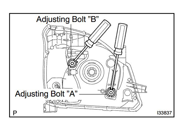

    Thanks guys. Found it and just did the adjustment. the 8mm nut was the clue I was looking for. A small 8mm socket is probably best for this job, but I had to use a spanner (of all sockets my 8mm is missing!)
    I just adjusted the "B" bolt which is the horizontal adjustment which did the trick. It is easiest to get to. "A" does the vertical adjustment. see the diagram. click on the file to see what I am talking about . Good luck

      And don't adjust too far. If its not moving as expected try the other screw bolt. If you go too far it will pop out of its hole and the light will go floppy.
      Floppy is not good.
