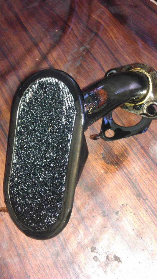

                • Originally posted by Benny78 View Post
                  That's not good news I'm afraid. Mine developed a ticking/rattle with no loss of power etc.
                  pulled motor apart to find no1 cylinder scored from the piston. This was due to a blocked oil pick up screen. All relates back to an injector seat failing and allowing blowby to occur.
                  I cannot believe that TOYOTA do not accept this is a common fault and a manufacturing defect.
                  Bottom line is sounds like a new short motor.
                  Hope I am wrong but give me a PM if you need any info as I have just been through this exercise.
                  Guess, what? Just got the news today - the exact same thing.
                  Oil screen full of carbon, engine starved for oil. #1 Cylinder scored.
                  Will be talking to insurance company when I get home. Not impressed, to say the very least.
Name:	Ennis oil pick up.jpg
                                This is probably the extreme - and as far as I can tell, Toyota doesn't even look at the P/U screen on a service....
                                But that is the condition of my screen when engine was making "death rattle"....
