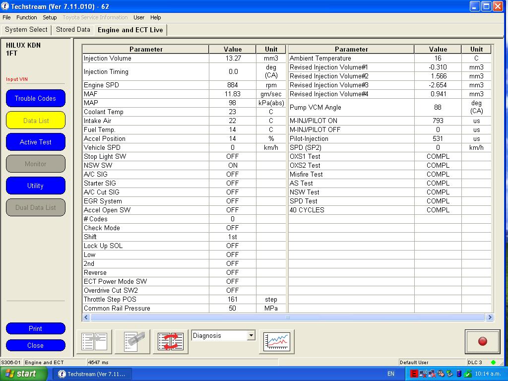

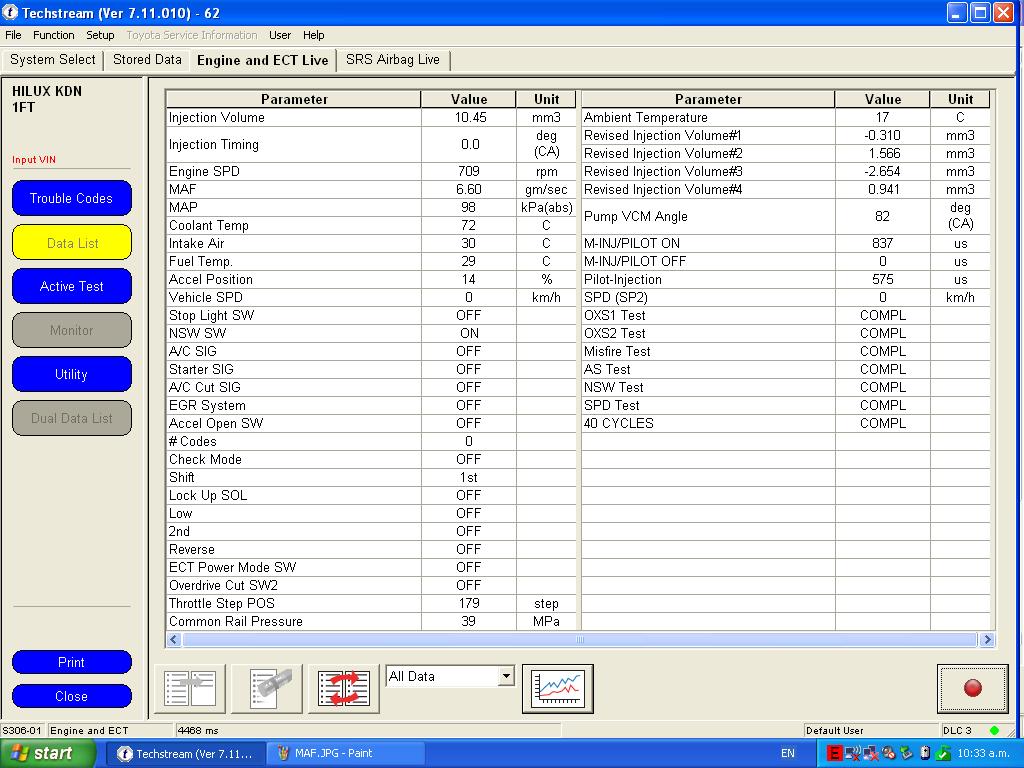

      Ok so hear are the values when it is running cold and when warmed up.
      Cold

      Warmed up

      Results:
      Injector volume (5mm3 - 12mm3):
      Cold slightly high at 13.27mm3 (884rpm)
      And when warm drops within range 10.45mm3
      MAF (8g/s - 13 g/s)
      Cold 11.83gm/sec (884rpm)
      Warm 6.6gm/sec (709rpm)
      MAP ( 95kPa - 105kPa)
      Cold 98kPa
      Warm 98kPa
      Common Rail Pressure: (30MPa - 40MPa at idle)
      Cold 50MPa
      Warm 39MPa
      I did perform an active test on all injectors one by one and each one causes the same rough idle when cut off so all injectors appear to be operating normally.

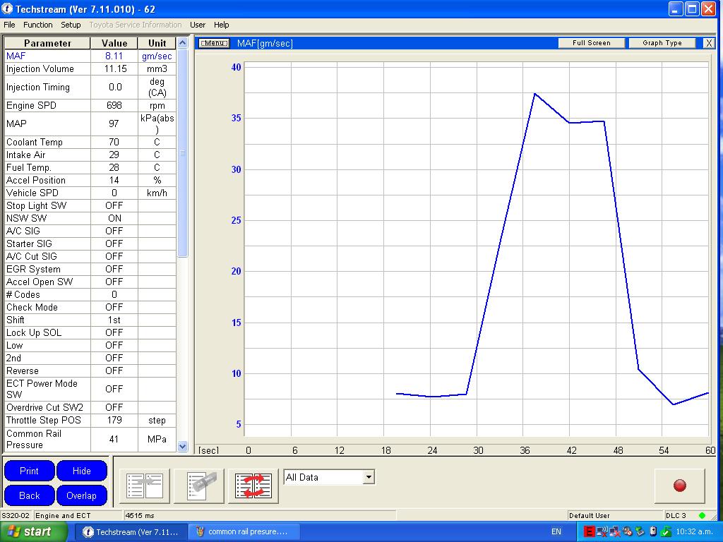

      I also graphed the common rail pressure and MAF sensor and they appear to be doing their thing when the engine is accelerated.
      MAF

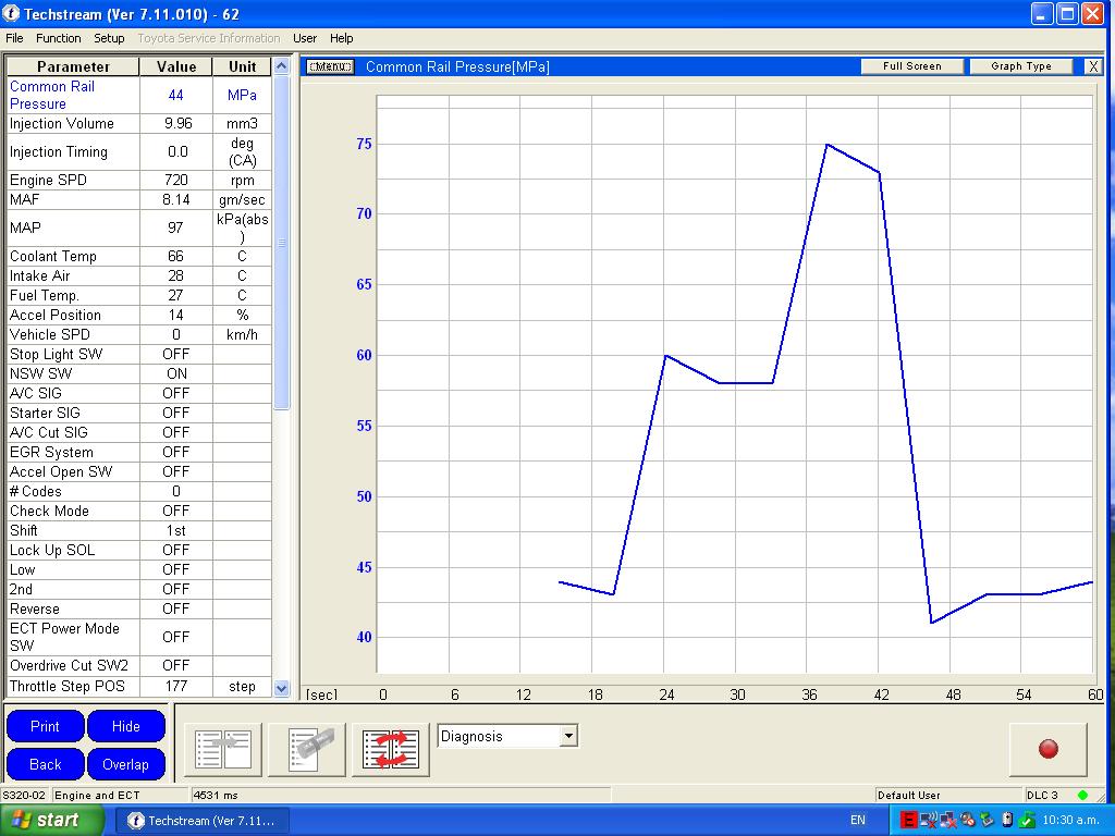

      http://www.geektech.co.nz/images/commonrailpressure.jpg
      I haven't tested the common rail under acceleration as the truck will go from 100kmh to 140kmh no trouble at all.
      So to recap their does not appear to be any glaring issues with the injection, all sensors appear to be working.
