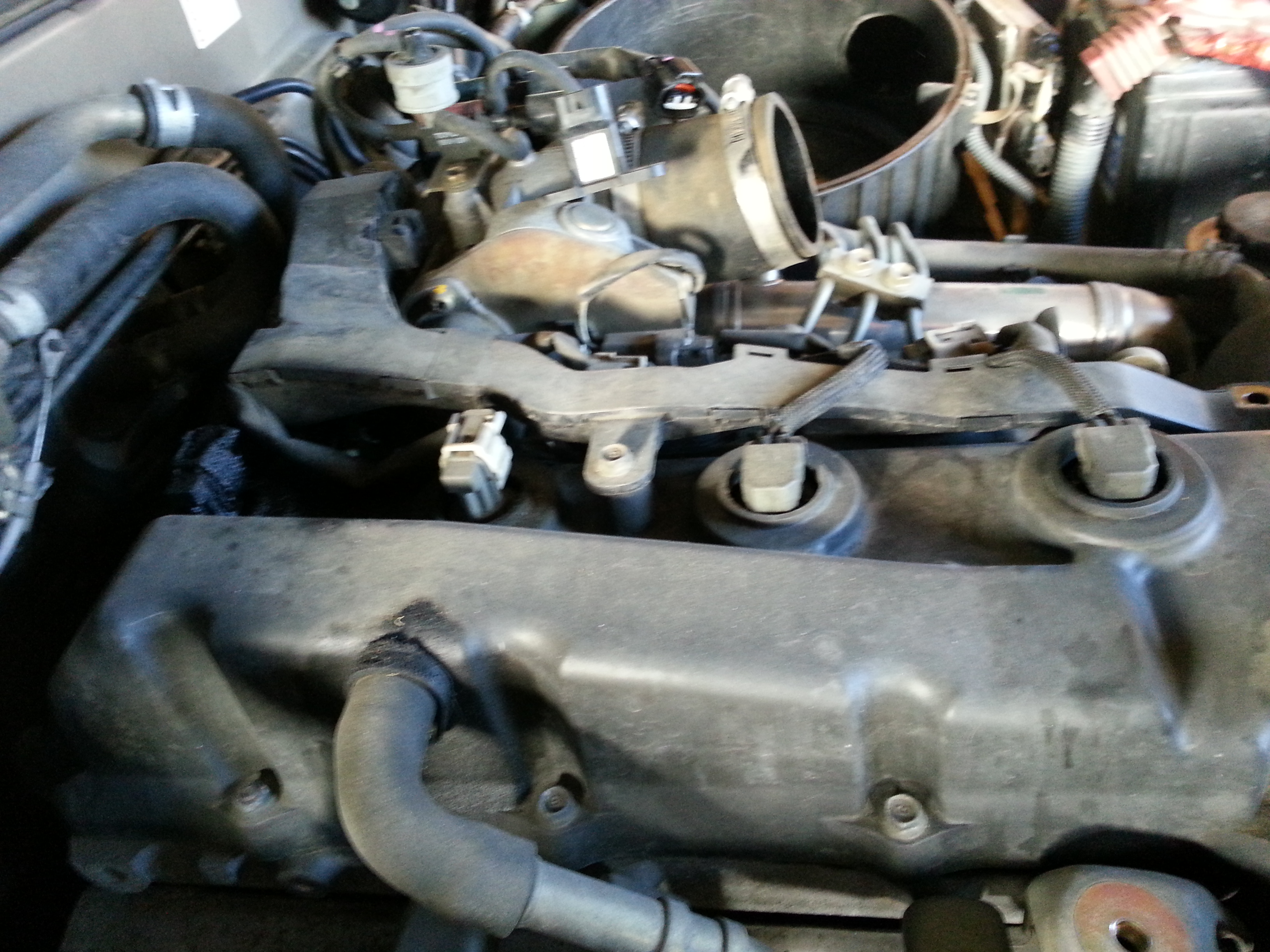

    07 Prado 120 D4-d
    • #4 seal looks likley to be the issue
      Finally got the time to pull the SOB apart, before even getting the rocker cover off it looks like #4 has a blown seal.
      After removing the cover and pulling number 4 it was confirmed the seal was blown, so glad to be in the road to recovery now.

            • Blown Seal
              Here is the photo of the seals pulled from the injectors. #4 was the issue in this case.
                      Aren't those the original copper seats?
                          I would say so, I doubt that the rocker cover has ever been off on this one, has done 168km but by the looks of the amount of blow by that had even escaped onto the top of the cover it has been blown for quite some time. why the previous owner didnt think anything was up is beyond me.
                          The kit with new seals came with the coated kind. FYI.
                          I have an inspection camera now and will post a shot of the sump screen when i have it. not very much sooty crap at all on the top so im keeping my fingers crossed that the sump screen is still relatively clear but it is definitely going to be checked!!.
                          BTW this is a 2001 D4D in a Hilux Surf, these early model D4D injectors are not coded, it is up to the ECU to workout the injection volumes for each one as their are no codes to enter into the ECU..
