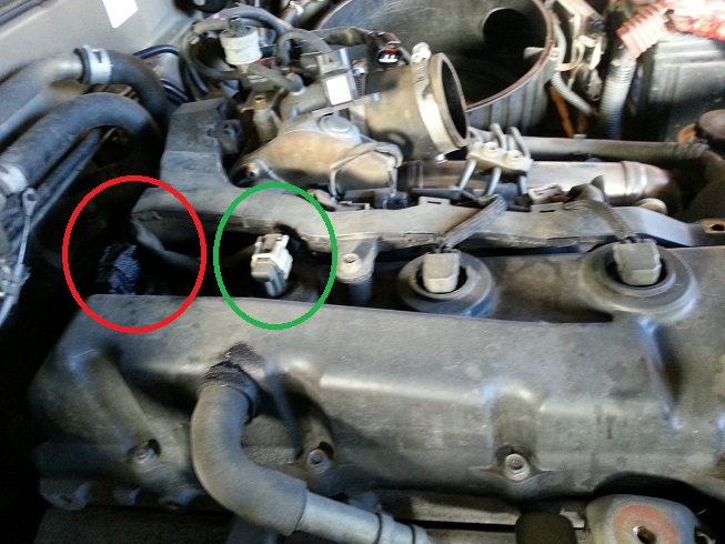

          Pulling off the inter-cooler reveled the likely candidate.

          #4 was covered in crud (technical term) which tells us that this issue has been present for quite some time.

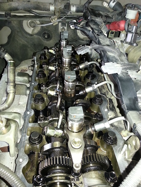

          So on to pulling the injector to see what was going on

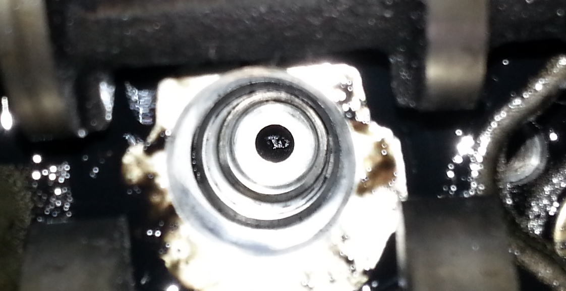

          Injector port number 4.
          You can see the gunge (technical term) down the injector port, a result of the previous owner ignoring the issue.

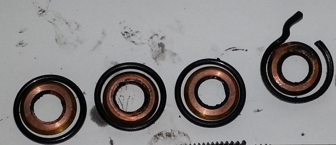

          Shot of the injectors
          New seals were of the coated kind.

          Well the information here is worth 10 fold of what his 4WD club gave him, as if you look at the condition of the connector for injector #4 the issue had been happening for quite some time.
