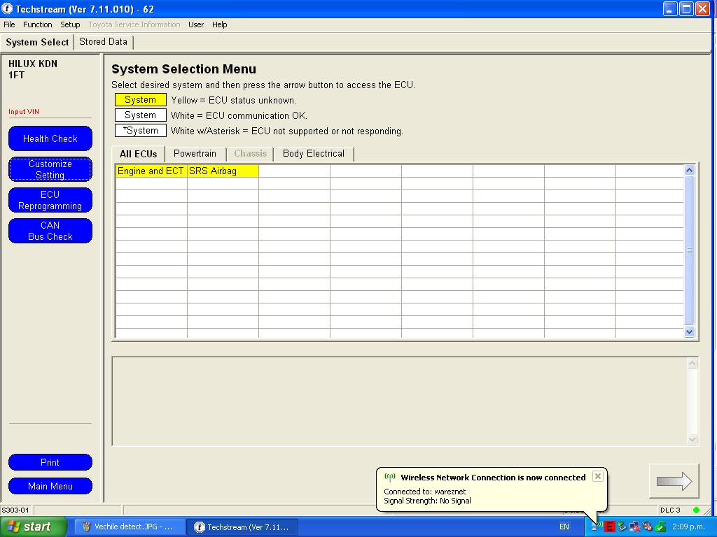

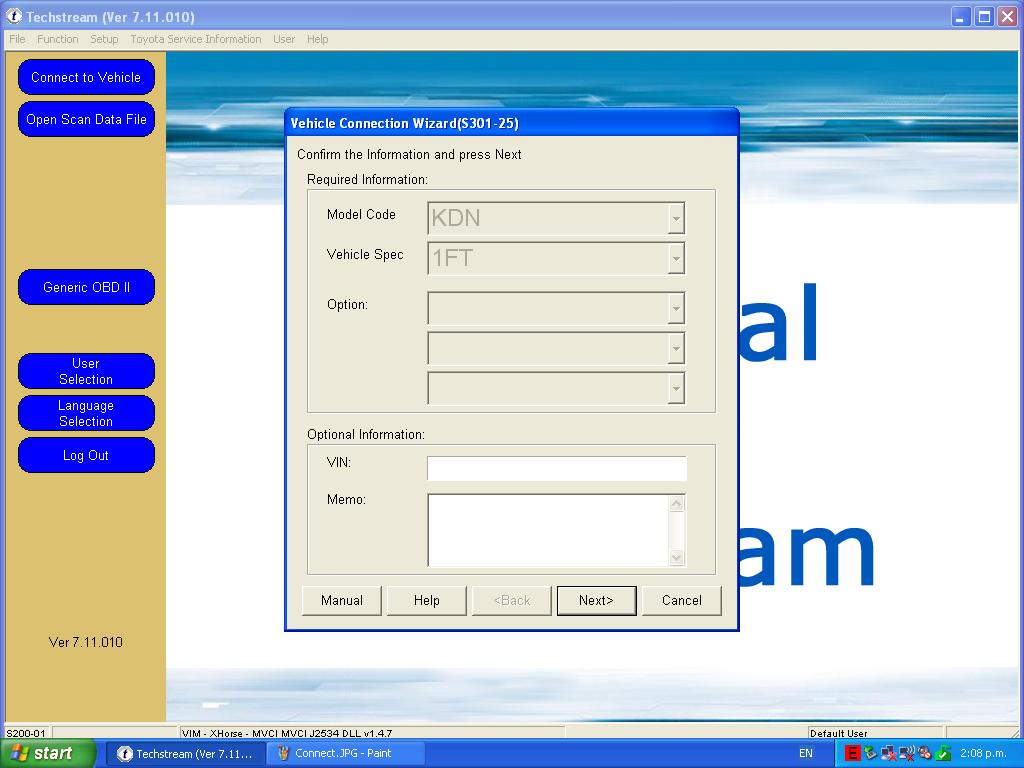

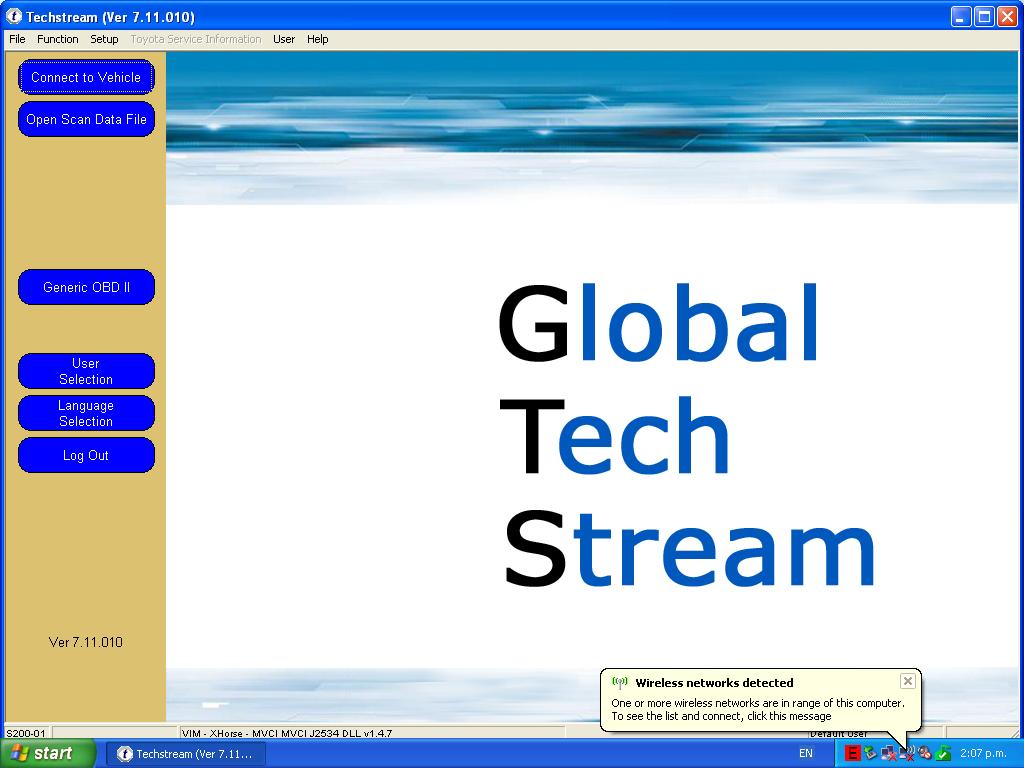

    • Redstorm I got my VCI dongle and techstream delivered today. When I tried to connect to the ECU the software asked me to enter the model of car. The Prado wasn't an option and it wasn't covered under landcruiser. Which option do you select to connect to the prado ECU?
      Thanks,
      • When you installed did you select Global Techstream? I didn't and my Hilux wasn't auto detected either, I switched it to Global Techstream and then it worked for me.

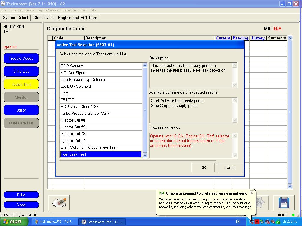

        • Checking for a fuel leak after replacing the injector seals. no error was thrown so i assume it passed.
