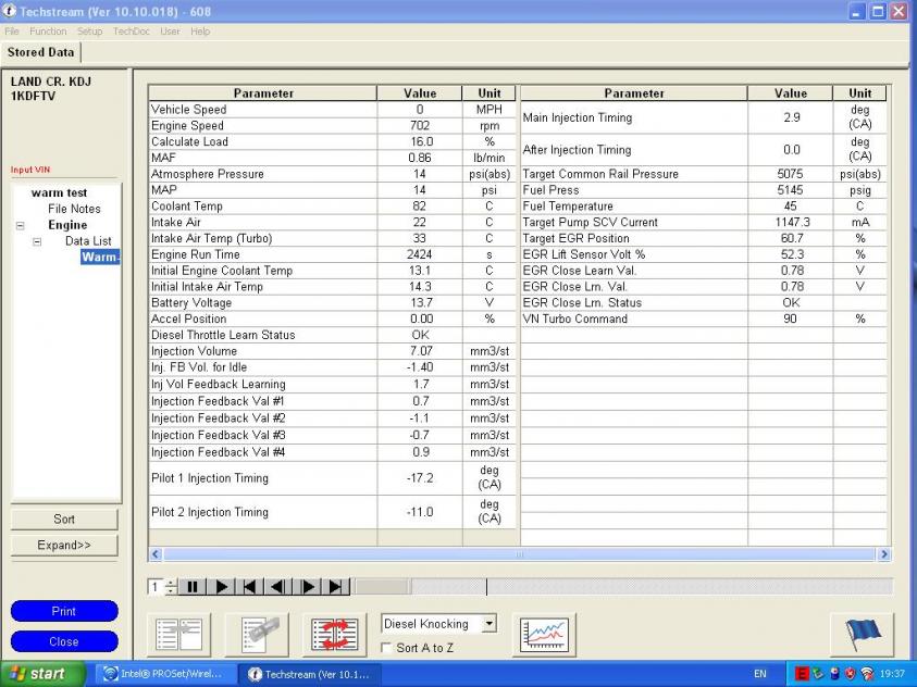

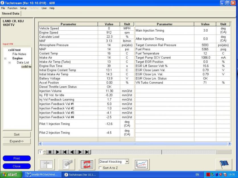

                            • Hi
                              My car has done 114,000 miles and makes a real racket when left over night to completely cool. So recently had my injectors supposedly serviced but I have a suspicion they have only had new tips and been recalibrated. I think the rest of the mechanics inside may have remained untouched. Anyway attached are my warm and cold techstream captures. Whats the thoughts ? Once shes warmed up shes absolutely fine.

                              • Originally posted by Sirdread View Post
                                Hi
                                [ATTACH=CONFIG]21660[/ATTACH]
                                [ATTACH=CONFIG]21661[/ATTACH]
                                My thoughts are, get a new set of injectors in there before its too late!
                                Whoever you went to have no idea. Those Injectors are flogged out bad!
                                With a fresh set you will be very happy.
