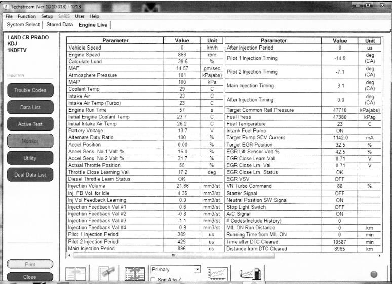

        What is the total injection volume?
        • To be honest that's all I recorded, will run again and send through the data
          Cheers, Drew
          2008 D4D Grande, ARB bar, winch, dual batts, Safari snorkel, Tough Dog 2" inc AMTS airbag spacer, Korr lightbar, Frontrunner Rack, Outback drawers, rooftop tent, Cooper ST Max 275/70, AMTS rear wheel spacer & light, TJM compressor under bonnet with AMTS bracket, Wetseat covers
          [B]If its not fun I'm not doin' it![/B]
            Cool,
            Injection volume 21.66, have attached screen dump. Interestingly slight differences to yesterday
            Drew
            • That total volume is a bit high, but your engine run time is only 29 seconds. You should run the engine from cold and watch as the volume should decrease as the engine warms up and ideally be well under 12mm3. Mine starts at about 13/14 and rapidly drops to high 6 low 7mm3 as engine gets closer to 80 odd degrees. I'm sure #### will comment on that figure you have shown. Like this:

              • Injection volume off the chart - are you sure that's at hot idle with no electrical loads on or A/C
                07 Prado 120 D4-d

                  I think run time was 57s. I was under the impression readings should be taken about 1 min from cold start? A/C would have been on (climate control)
                  Are you able to point me in the right direction for testing? Wait until temp is 80°C? Wait for total volume to drop?
                  Drew
                  • Start with engine cold, ie first thing in the morning. All accessories, aircon, fans, etc should be off so that the only thing running is the engine. Take a snap shot at start up, and then monitor as it warms up. The injector feedback values will alter as she warms up and should settle after a few minutes. Some will say anything up to + or - 2.5 is acceptable, Toyota will say anything up to as high as + or - 5.0 is okay but most here agree they are dreaming. Other diesel mechanics will be happy with up to + or - 3.5. One of my old ones pinged at +2.7 and I binned the lot. The injector total volume will initially be high (cold start), mine starts at just under 12mm3, but will quickly reduce as the motor warms. There is also an acceptable value for the fuel pump pressure deviation from target fuel pressure (which I can't recall) and this will indicate whether it's time to replace the SCV.
                    • 170k = shagged injectors.
                      That's why I asked what's the total volume.
                      Everybody seems to be focused on individual feedbacks alone.
                      Total volume too high for cold start.
                      So what is it at 83 degrees? Please.....

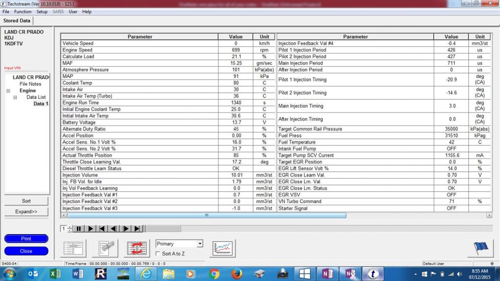

                        Hi ####,
                        You will have to excuse my ignorance, I am not a mechanic and am just trying to get my head around all this stuff from what I read on the forum. Following the other comments I ran techstream again yesterday, below are the results at coolant 80 degrees. Is this close enough or shall I run again at 83?

                          • Originally posted by drw67 View Post
                            Hi ####,
                            Thanks for your help
                            No problamo
                            That's ok at 80.
                            The total volume is a bit high, reflecting wear. Between the very high cold start figure & only going down to 10ish warm, you need to renew them.
                            BDG recommends from 9mm is time to replace.
                            I note your egr position at 0%.
                            Is it always like that? It seems some are.
                            Have you done any egr mod yet?

                              Not good news...
                              Re EGR I haven't done the blanking plate mod yet. What does the 0% signify?
                              Cheers Drew
                                Not good news...
                                Cheers Drew
                                In your screen shot it shows the egr position at 0% so it's closed
                                It's all good news! You have done 170,000k on a set of common rail injectors & appears have not blown a hole in a piston or 2.
                                Time for them to go! That's all.
