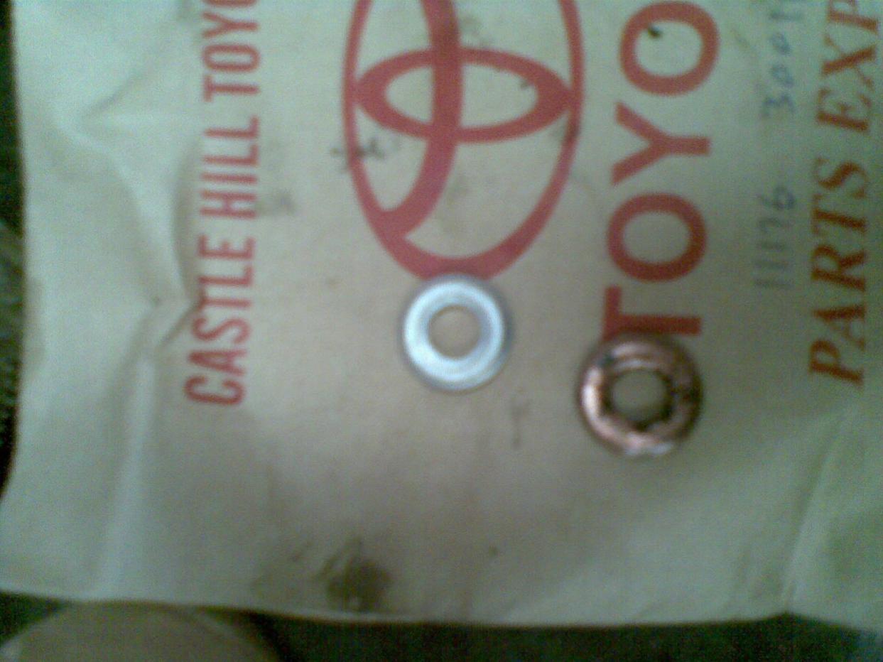

                              The seal part numbers may not have changed, but the seal sure has. The original seals/seats are made of copper, and the new ones are aluminium. The seating surface is only about 2mm. Bad design IMO. There was nothing stopping denso from making the seating surface on the injectors much larger in the first place.
                              To me, copper was also a bad choice of material in the first place. Talk about a dissimilar metal sandwhich.
                              Steel (injector), copper (seat) and alluminium (head)
                              I took some really crappy photos of the parts in question. (phone)
                              You still should be able to see where the copper seat has failed.
                              Steve
