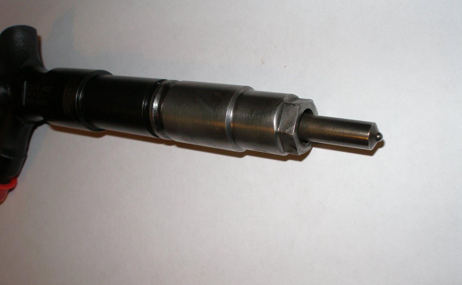

      Hi again Pedro,
      Mine is a February 2008. The injectors had been replaced before I bought it at 24k kms. This was evident by the injector codes which showed up using a new Carman scanner when coding up the new injector. Also, two rocker cover/injector seals had been split, and bodgied up with silicone.
      The nozzle on the injector that failed was still in good nick (Photos attached) although it has been cleaned up. It was caked in carbon when removed.
      As said before, we debated this issue to death over a few beers. I think that Toyota knows of the seats failing, but no one wants to talk about it. If you are correct, in that the part # for the seats has not changed.... well I think we can all draw a logical conclusion as to why that might be.
      Since my most recent posts here, I have received correspondence from 3 people who have experienced similar issues. One poor woman, who PP'd me from here, experienced a total engine failure, after the white smoke symptom was ignored.
      The white smoke and rattles seem to go hand in hand in many cases, but not all cases, from my reading.
      Anyway, mine is now powering along like new after relatively little work, and I now feel a lot happier with the vehicle, in that the issues of injectors which have worried me in the past are no longer veiled in dark and mysterious secrets.
      The fuel system on these vehicles isn't that complex at all, and despite what some here will tell you, is not that difficult to work on, given the right info and appropriate equipment.

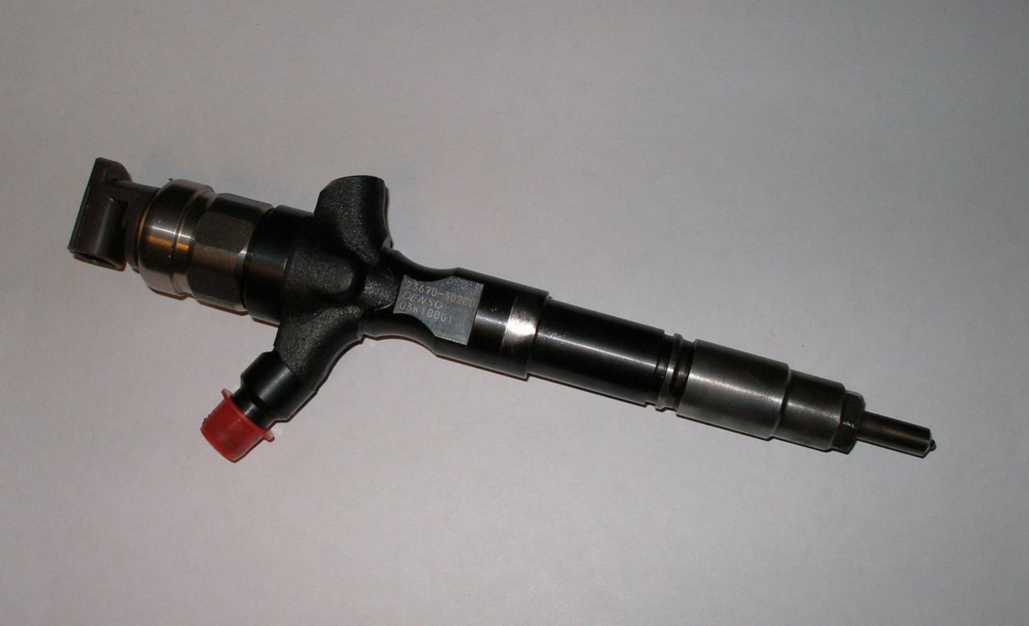

          • Steve the part number etched on the side of that injector doesn't line up with any shown on toyodiy and my local toyo parts place confirmed that those were the correct part numbers for Oz. Very interesting. Are there any other part numbers on that or other injectors?
            Michael
              Michael
              Michael, There is a 31 character alpha numeric code on the top electrical connector on each injector. This is the code used to program each individual injector to the computer.
