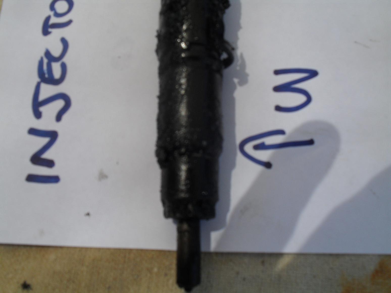

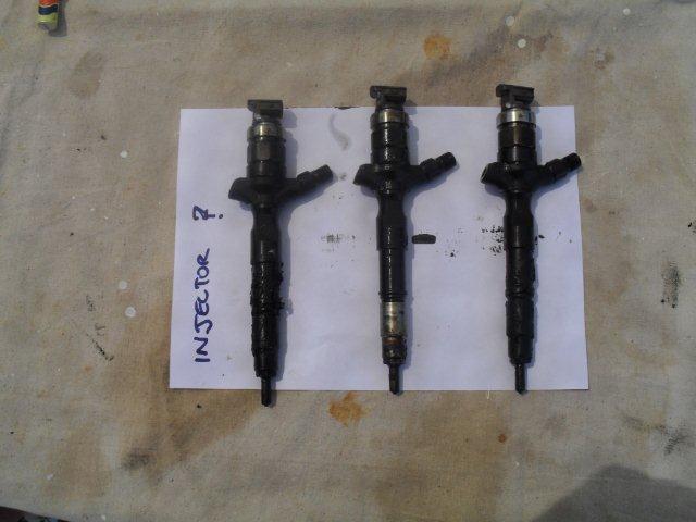

          Hi all, Im SHARON (the one Roos been talking about); Im from SA regional and have had a recent disaster :cry:. Which like everyone else led me to google the probelm, isnt technology amazing!
          Mid December I was driving my Toyota Prado D4D 120 home, just pulled up at the lights and the car started to chug like a tractor. You can imagine, my thoughts 'What the heck' Progressed further through town, same thing happens everytime I stopped. I got half way down the main drag to our property, and the oil light comes on, I lose acceleration, the car is now staggering; of its own accord into my street. I managed to get off the 80k zone and rolled into my street leading to the property. All of a sudden I lost all control of the car, all of the lights on the dash going berserk (looked like a aeroplane cock-pit), the card stopped (turned itself off).
          Now I just had my 130K service. RAA man came to my rescue (God Bless him) and after the car had sat for 1/2 hour the RAA man checked my oil, and I had only 5mm at the end of the dip stick (way below the lowest level indicator), he said "that's not good". Meanwhile, Im thinking OMG this is going to be bad...... you know when you get that vibe from a mechanic...lol He turned over the engine, she starts up, again sounding like a tractor, he says "I'll arrange to tow it to a mechanic for you...." Beeds of pespiration are now appearing on my forhead....:shock: Now I know Im in real trouble. Well it went to Toyota and sat for a few days.... and they'd assured me they would call next day. Well, they didnt..I had to chase them up.
          My partner and I went to visit the Service Mgr. And was told that there was a possible injector failure and its caused by bad fuel, not driver deliberate.. I did have to sign a form to allow them to investigate the problem further. The Service Mgr. said my cost to replace all 4 injectors will be $4,000 and worst case scenario $10,000. I won't tell you the story you've heard it all before
          Well since that point I have been toing & froing from Toyota, to no avail. They let me borrow a loan car for a week. I went back to see the Service Mgr - and he told me my engine was broken beyond repair, throw it away and put a reconditioned engine or a new motor. It would be cheaper for you to just put in a new engine, and the cost is around $20,000. Im having heart failure by this time. He went on to say that he would put in a GOODWILL request, as he had a customer recently with a Sahara same problem (out of warranty - 120k's) and Sydney Head office approved the repair - at no cost to the customer. He puffed himself up and said - "I fought for 3 months to get this for my customer", I'm thinking GREAT - I told him to put his gloves on for me too. The Service Mgr then said 'I'll fight for you all the way, as long as it takes". He's resigned from Toyota, last week. Hmph....FAMOUS LAST WORD - Coward!!!!
          Anyway - I sent a letter to Toyota Head Office to the 'CUSTOMER EXPERIENCE DEPARTMENT'. Mind you the letter was sent in a distressed state of mind.... a tad harsh Within a couple of days I got a call from a 'Customer Experience Consultant' Rob Marsh, the conversation lasted 3 minutes. He said that "Toyota Australia have rejected my repair claim, YOU DO WHAT YOU HAVE TO DO (Small Claims Court), and NO; I wont answer your questions in the letter and by the way the Dealership wants there car returned by 5pm today". Now, people I have an extraordinary situation. I have a DVO against my X husband, this is my second move to seek peace and quite enjoyment. I also live in a rural area, which necessitates having a vehicle - there are no buses. Head Office was aware of this before Mr Marsh gave his ruling - so my customer experience was a zero. These are the questions I asked him:
          1. In relation to the inspection report (attached).
          a. My understanding is an identified injector failure – is this correct?
          2. How often should the injectors be serviced?
          3. Would you be able to point out to me where that is stated in the owner’s maintenance manual?
          4. Why hasn’t Toyota Australia contacted me with relevant information to the injector failures?
          5. If Europe & New Zealand Toyota are aware of injector problems and have recalled cars to fix these problems, Why is Toyota Australia not doing the same?
          Harmless questions - warrant an answer.
          After my nasty dealings with Mr Marsh, I decided that Toyota Australia are not going to fix my car. I arranged to get it towed back to the property. I also received in addition to my parts, someone elses radiator shrowed & engine shrowed. My car came back with a flat battery (which was purchased at time of 120K service). I have got a picture to show you my injector no. 3
Name:	Injector 3 (12).jpg
ID:	641907 Click image for larger version
Name:	Injectors - 3, 1 & 4 (1).jpg

            As per our telephone conversation we can, to the best of our knowledge confirm the following :-
            1. Injector nozzle (assembly) number 3 has failed
            2. Damage has then been caused to the piston/cylinder number 3 due to the injector failing
            3. Feedback values for the injectors are 1 (2.2) 2 (-1.8) 3 (-5.0) 4 (3.1)
            We can see by looking into the top of the cylinder that damage has been caused and believe the best and cheapest option to repair is to replace the engine assembly. There maybe possible turbo damage also if metal particles have exited the engine and gone out through the turbo.
            Without further diagnostic and testing (which would be at your expense unfortunately) we can’t confirm this 100%.
            The approximate cost to replace the engine and turbo including oils and sundries is $20,000.00
            If we were to overhaul the engine the labour cost alone to do this is approximately $5000 excluding parts and oils. But we may then find that there is more damage, and the engine would need replacing anyway.
            It is impossible to tell the stress the other 3 injectors have had due to trying to compensate for number 3 failing so a future failure may also occur causing the same outcome.
            From the tests we have done we can confirm that an injector has failed but this could just be down to normal ‘wear and tear’ as the vehicle is now 6 years old. A manufacturing defect, if there was one would have caused a failure a long time ago.
            Just to let you know the car was first sold in 2007, I brought the car 2009 at 53K's. At time of break down, I had 138K's on the clock, so my engine is young. As of the 14th of December my car was still 5 years old. It has had regular services with a registered business mechanic. I brought this car in GOOD FAITH.
            I intend to fight Toyota , I cannot afford to fix my car - it will sit until Toyota Pay up. I intend to take this to small claims court and stick it to them [nicely]. Since this problem I have been warning everyone I see with a Toyota Prado & Hilux - the movement is on in the country region. People are going to the Dealerships with their vehicles. - and checking on the injectors. My partner has 2 people he knows personally at work who have had the same problem that's 2 out of 20 people. Both had to pay for new engines - one in warranty & one out of warranty.
