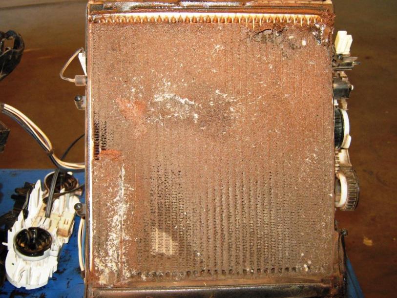

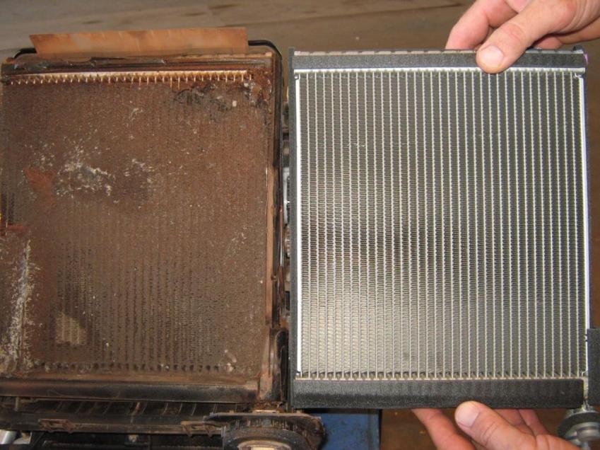

Hi guys , just finished off a lovely job replacing the Evaporator in a Hilux KUN26 2006 build , i know its not a Prado but it is basically the same setup underneath all that plastic

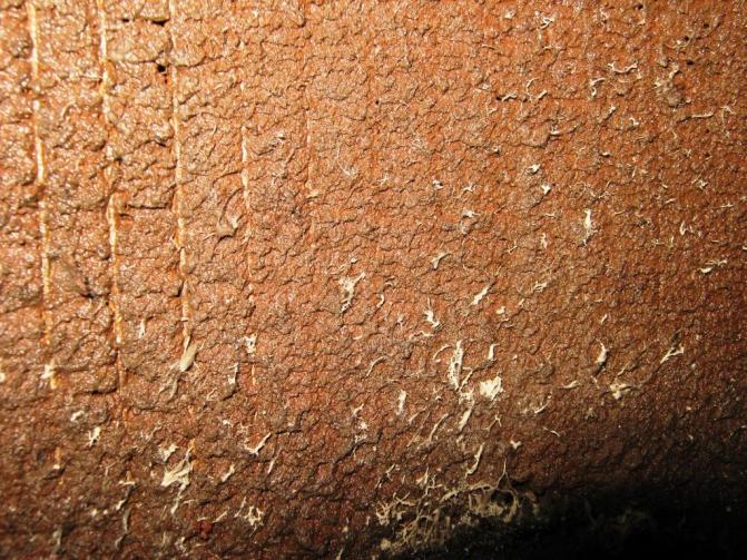

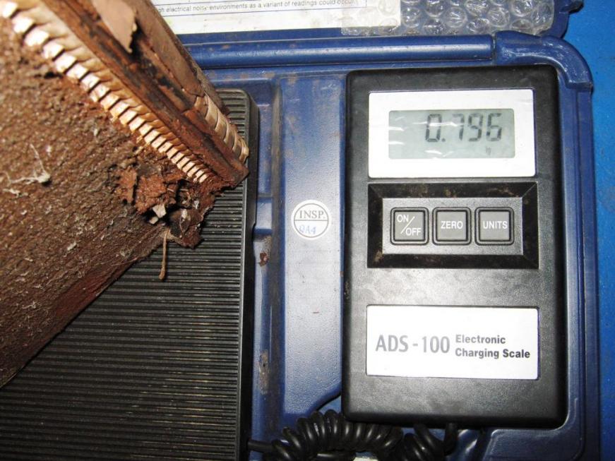

This is the result of no cabin filter , it has done 160000 kms , i will let the pictures do the talking

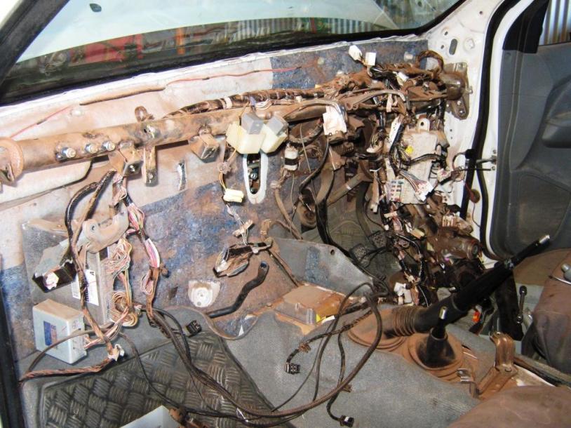

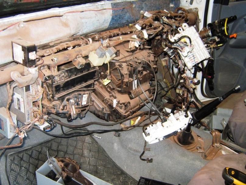

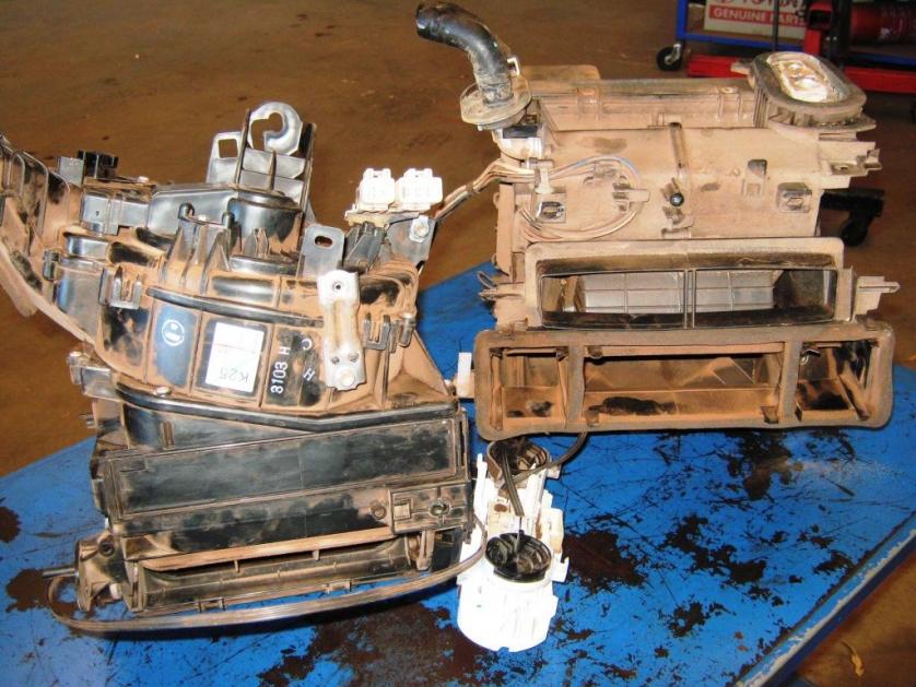

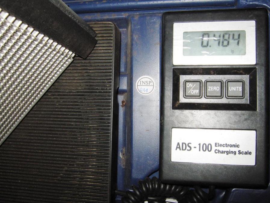

All up it was a 7 hour job to replace it
this is an extreme case , but you can see the result
