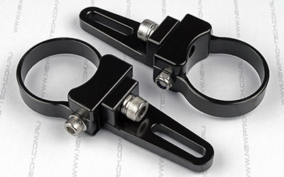

    Jus. It seems the secure type brackets aren't made to fit the ARB bar. They aClick image for larger version
ID:	645823re either side (size)of it.
      Thanks MidLife. Would heavy duty mounts from the bottom of the light be better? Something like a pair of mounts that could slide along inside a recess so they can be adjusted to fit different hole centres? How about the actual mounting brackets themselves, would 5mm 316 stainless be considered tough enough for the 4wd market do you think?
          Oh dear, no idea. I just want something that looks cool and does a great job. Drawing would help my small mind
            I read another PP member just used UHF aerial mounts upsidedown for his lightbar on the bullbar. Little dab of Locktite and they would never move!
              I'll see if I can either steal a CAD drawing of the new brackets or take a cheeky snapshot when they land on my desk.
