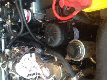

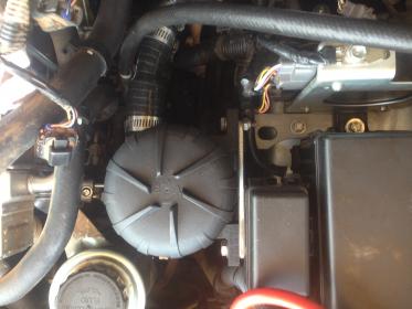

                    • Fitted a Provent 200. About the best spot I could find its out of the way but easy to change filter out when required. I've run the drain on top of the chassis rail so the tap is easy to get to when I need to drain it.
                      2008 Prado GXL D4D Auto Silver, 265/70x17 Mickythompson ATZ 4 ribs, ARB delux Bar Avenger Mako 9500 winch, TJM XGS Gold suspension, Poly airs, Safari Snorkel, Dual Battery system, Voltage Booster, Lightforce XGT lights, GME TX3100 UHF,ARB CKMA12 Compressor, ENZD special quad breather kit,Outback Draw system 1/2 Cargo Barrier,Kaymar duel wheel carrier,AJ120 Sliders, Taipan XP Exhaust, Twin E Lockers, Foxwing, Pioneer Platform.
                      • Originally posted by wsp View Post
                        Tight but good fit Wayne.
                        Did it come with the brackets or did you make them yourself?
                        • I made (modified) a bracket that came with the FM100 fuel filter kit that I didn't need.
