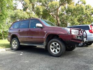

      • Had a big week for the 120!
        ARB deluxe bar fitted. Came in a grey colour, which was a surprise... but looks almost colour coded next to the charcoal 120!
        Also rear air locker and underbonnet compressor went in.
        Breathers fitted to Diff's and Transmission.
        Fitted my Bushskinz front/sump and transmission guards.
        Fitted my AMTS Recovery points on the front.
        Starting to look like a real 4x4 now.
        Tested it out with a day trip to Fraser. Fully loaded with 6 people... found the suspension lacking... not entirely surprising.
        Finished up with a big clean out of sand in the engine bay... time for the lift. Booked in for a week thurs. That's it for the majors! Credit card needs a break...
        Be time to test out Glasshouse mountains once the lift is in... looking forward to breaking off my sidesteps...
        - Ben

                          That's awesome Ben! What suspension did you end up going for?
                          • Went for Old Man Emu. Opted for softer springs in rear as it's usually unladen. Can always beef up with airbag inserts if needed in future...
                            Suspension goes in a week thurs.
