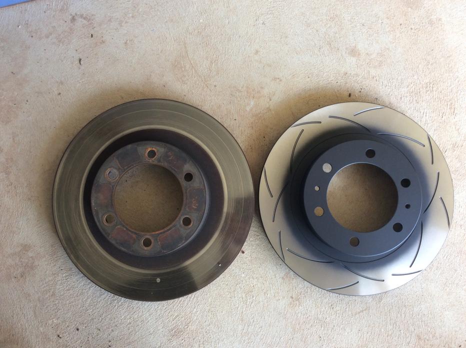

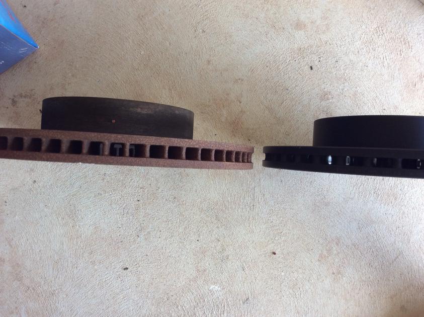

      • Front Rotor replacement
        Replaced my front rotors with DNA 4X4 survival brake series.after fitting and taking for a test run they rub something out of this world on the backing plate.It looks like the internal diameter is smaller than the stock rotors.With some hammer work I have managed to quiet them down some what.

        • Are you sure you got the right rotors? I fitted same same and no issues at all.
          Yours looks slightly smaller.
          I would be doing some measurements and comparing to what they are meant to be. Maybe wrong rotors in the box. Or wrong altogether..
          • They MIGHT be the wrong rotors. Possibly for a hilux or something? What was the part number on the box? 120 4x4 T3 fronts should be DBA42700S

                            Yes they ended up being the incorrect Rotors for the Prado.4WD1 was addimate that they had supplied the correct product.After a call to DBA I now have the correct product and they have taken the incorrect Rotors back.Also updated there website with the correct product.
                            I,m an expert at replacing Rotors now.
