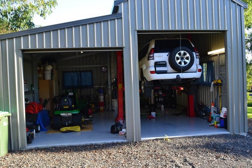

                            • 5 way wheel rotation, rear left Firestone air bag out for some soapy water and a few pictures (chasing a slow leak around the air line fitting),
                              Greased all uni joints and prop shafts.
                              Removed AMTS under body Armour - in prep for trans service. Pulled out starter motor for a clean up and re lube.
                              Checked drive belt and idler pulleys.
                              Envious of your workshop and hoist there Lowrange...
                              I have to be content with - trolley jack, axle stands and garage creeper!
                              Troy
