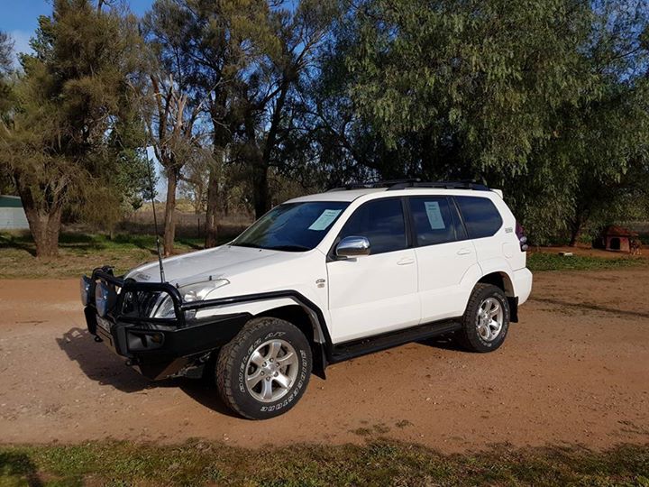

                    • Hi all,
                      well being a new member to PP this is one thread I hope to be on regularly,
                      First I bought a 2008 GX and it only had 120000K's on it, Diesel, manual, 180ltr tank, it was a one owner from a small country town and it's in very tidy condition,
                      as you see in the pic it came with Bullbar, driving lights, duel batteries and UHF so now to start adding the extrasClick image for larger version

                      • Welcome phattstump. Nice rig. First thing I would do is check the history of the injectors and injector seats. Plenty of good info on the diesel motor threads in the 120 &150 sections. Also drop your oil and check the pickup screen.
                        • Thanks Hogey
                          it's going in for a full service to get all diff oils, transfer case etc done,
                          so should I be looking at replacing the injectors or just an inspection
                          regards Peter
                          • Get a good mechanic that is well versed in the D4D motor. Definitely get them to inspect the oil pickup when oil is drained every service. Get injector values checked cold, drop off to mechanic the night before. Speak to the previous owner if possible in regard to whether the injector seats have been checked/replaced as well as the injectors themselves. 120 000 seems to be the common age at which problems are likely to start. As I said before read up on the typical issues that these motors have. In most cases they are easily avoidable if looked after correctly. If not checked you may suddenly be up for a new motor, plenty have detonated in the past.
                            • Great to know thanks
                              yes have read some of the post and thought, what have I got myself into,
                              but like you say preventative maintenance is the key
