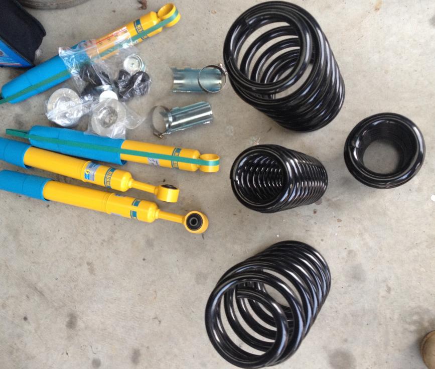

            • Received my new Bilsteins and RidePro suspension kit.... give me something to do in the next few days!

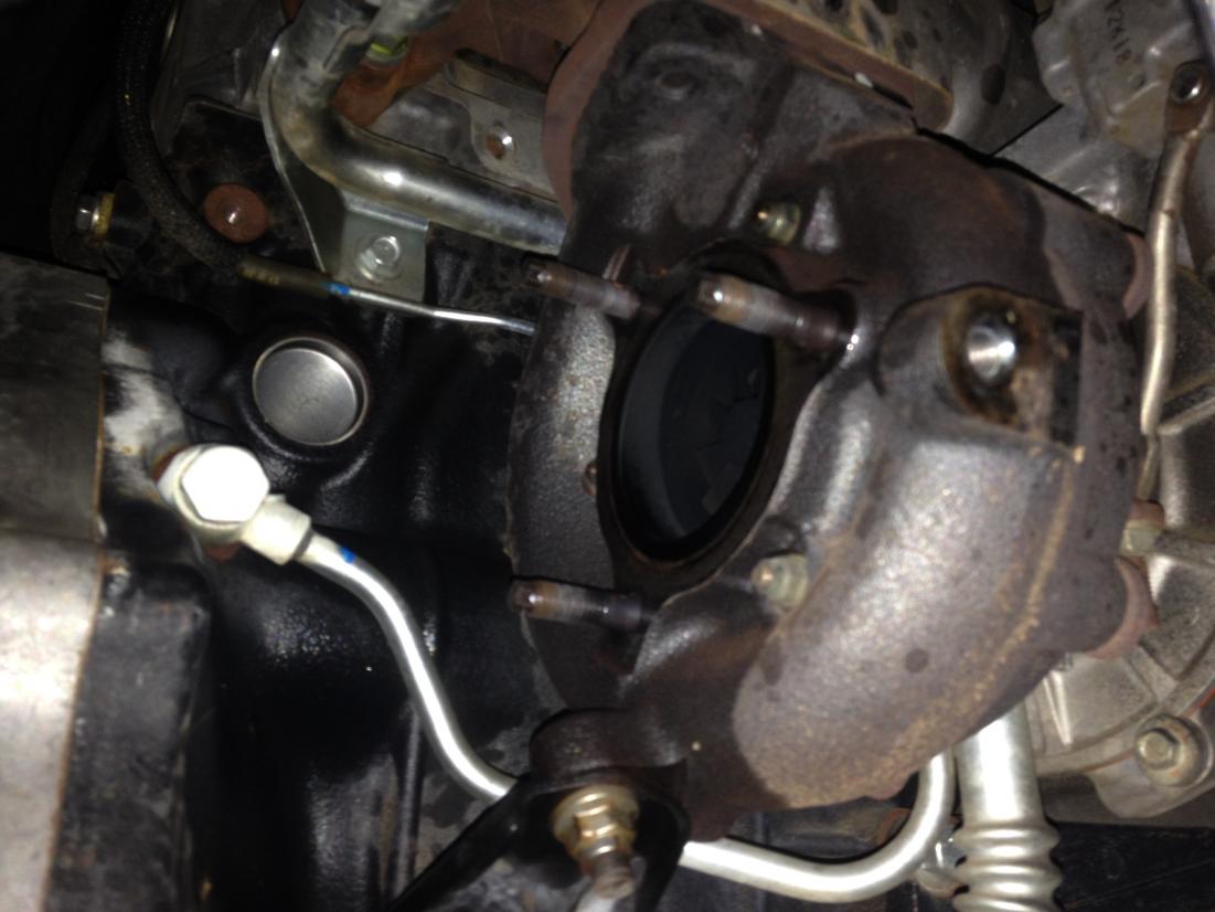

                I fiitted a turbo back 3" exhaust.

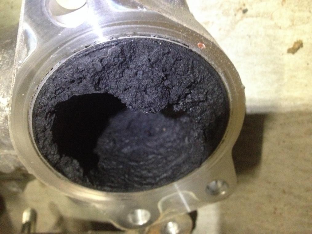

                I cleaned intake (aaaargh) then installed ProVent200 catch can.

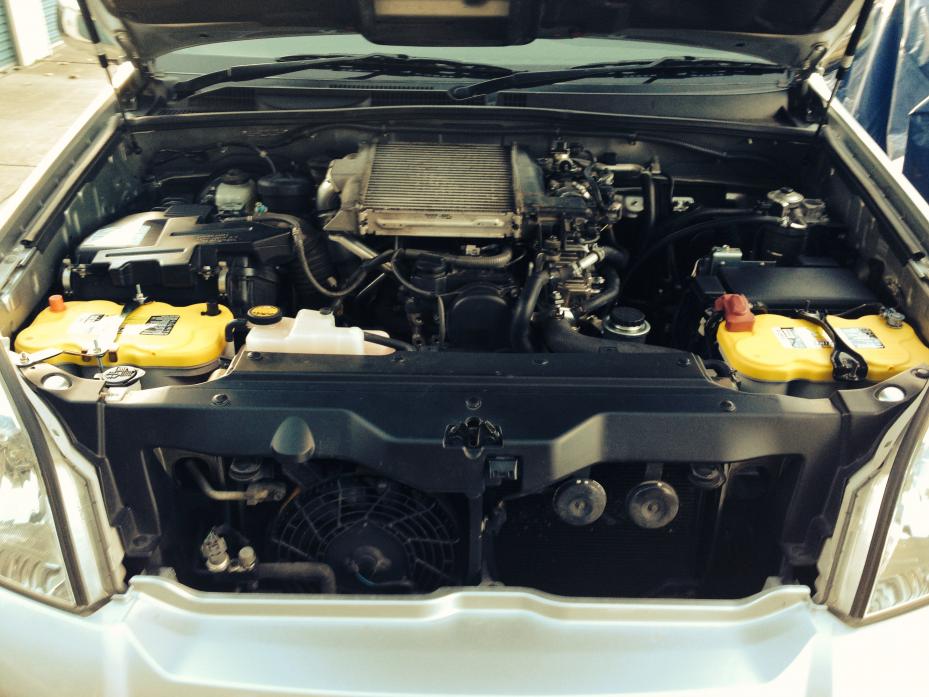

                I installed dual Optima yellow tops and Redarc SBI12 isolator.

                        • How many Km's on your car when you found that blockage ?

                            how many Km's did you have when you found this like that
                            • I bought it 3 months ago. 140,000km and never been off road - true story! Neither had the off road trailer that came with it for cheap $$
                              If you are interested and want to see if you are affected (as I see it is an OEM design fault) take off your intercooler (10 min job with a spanner or two), push the butterfly with your finger and shine a torch in. You will see the EGR valve and the elbow (my picture) on the other side of the EGR valve. I was shocked!!!!

                                i will do just that this afternoon
                                mine only has 72,000km but has done quite a bit of just highway use
