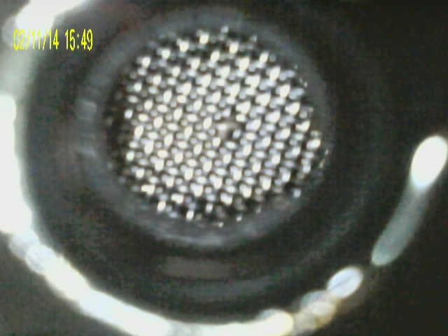

                    • anyone used that liqui moly engine flush before a service? i just gave my trusty 120 an oil change and ran a bottle through it, just waiting for the oil to drain now so i can check the oil pickup.
                      Edit:
                      looks pretty good to me
                      not the best photo, but sadly the camera wont fit in the sump plug hole
                      Cheers Joel
