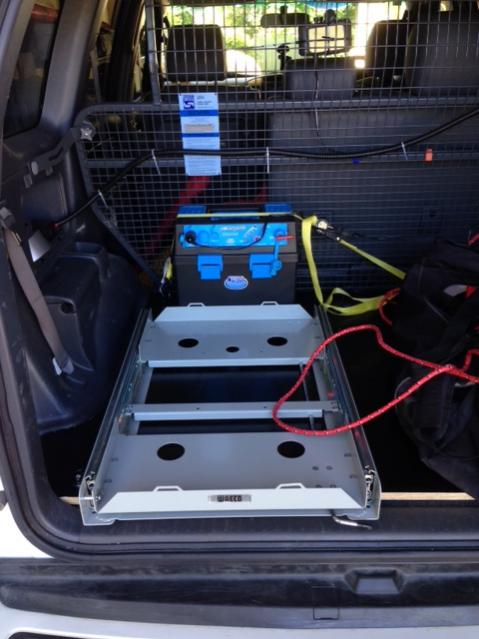

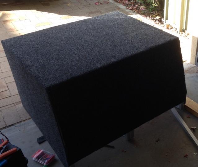

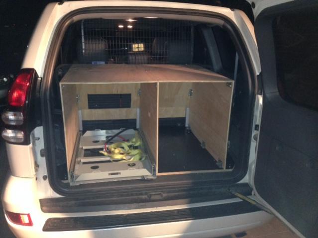

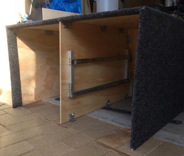

    • Beening working on the storage setup in the back. False floor fitted (17mm form ply) and bolted down with M6 bolts into the original tie down bolt holes. Waeco fridge slide bolted into place using T-nuts and M6 bolts. AGM 100Ah battery installed at rear of slide and wired via PowerTech isolator. Storage unit built from 12mm ply and covered with marine carpet over the weekend (leaving it out for the glue to dry). Two drawers to be built and fitted yet leaving the bottom section free for a couple of water jerries.

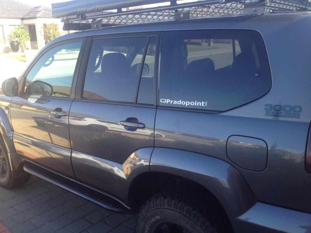

                              • Thanks to WOZCLEAN I applied a couple of very important additions to the rig today. Now it's only a matter of time before Geoff spots me around the northern suburbs of Perth!
