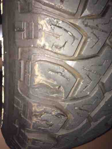

  • Rotated all 5 wheels yesterday, inspecting the rubber on each of the MT ATZ's. Lots of shrapnel like stones wedged tightly in all the little slots of the rubber to remove... Apart from the disappointment of the excess chipping of the lugs on my ATZ's, the overall wear is not too badClick image for larger version

              Rotated all 5 wheels yesterday, inspecting the rubber on each of the MT ATZ's. Lots of shrapnel like stones wedged tightly in all the little slots of the rubber to remove... Apart from the disappointment of the excess chipping of the lugs on my ATZ's, the overall wear is not too bad[ATTACH]18607[/ATTACH]
              Craig i have the same issue, I look after my tyre pressures but mine are badly chipped. (i do use them for their intended purpose but)
              They have worn ok, but very susceptible to chipping, so much so i probably wont get them again.
              Robert
              [B]Robert

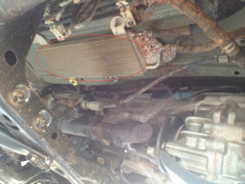

                            • Got under the rig to remove the OEM bash plates to clean up a bit of oil I spilled while taking off the fuel filter, ended up having a bit of a look around down there and came across this little guy. Can anyone tell me exactly what it is called and it's function? It has lines to the fuel tank so I'm guessing it's some sort of heat exchange? Just in front of the transfer case on passenger side.
                              Also, tried greasing the driveshaft at all grease nipple points. However, some of the nipples are blocked. Any tips on how to clean these while they are still attached? Looks like a tricky job to remove them to clean them or is that my only option?
