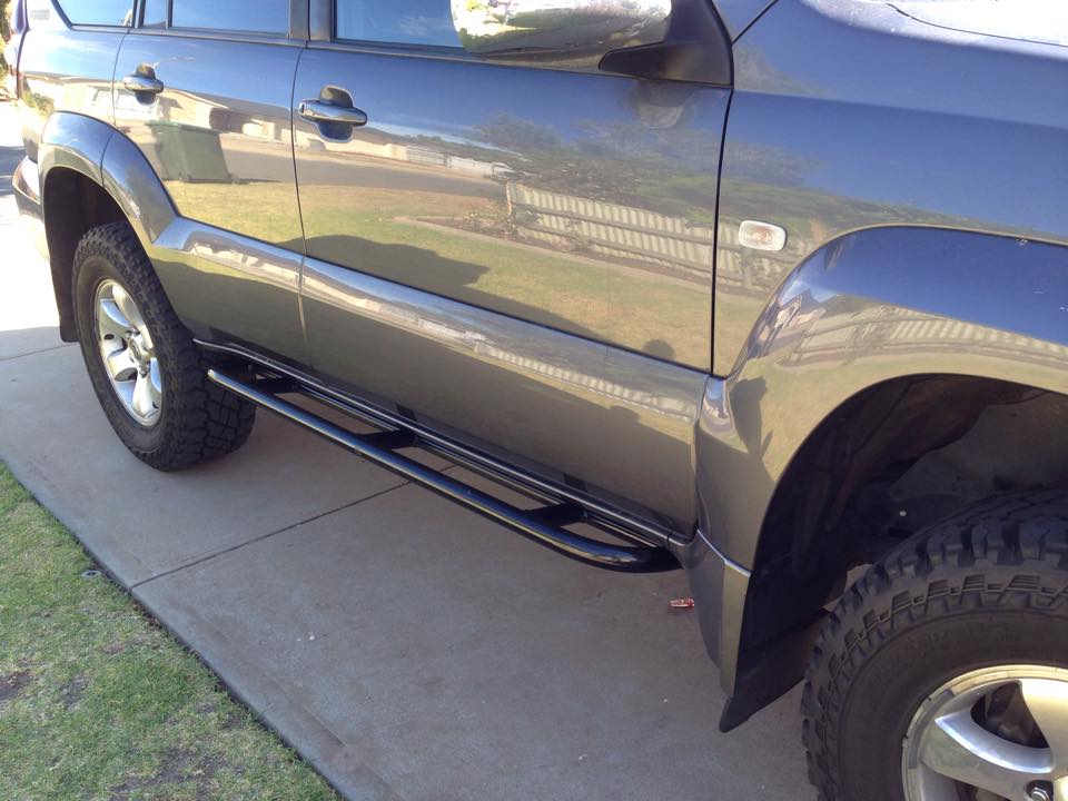

  • Got a 2" lift on Thursday and finished making my sliders and fitted them today (big job)
    Photo attached.Click image for larger version

    • Brisey,
      Sliders look great. What sort of suspension upgrade and lift did you get? Just finished reading the horror stories about OME and now have concerns as my 120 is booked in get a suspension upgrade this week. It's not too late to change my mind though so would appreciate any reviews you have after the first few days.

        Only went for a 2" lift rated to 150kg I think as I still wanted a comfy ride for daily use, I love it so far very little difference in fact probably better than before as the stock shockers were on their way out. Easter will be their first test, we are going to the Vic high country out of Mansfield.

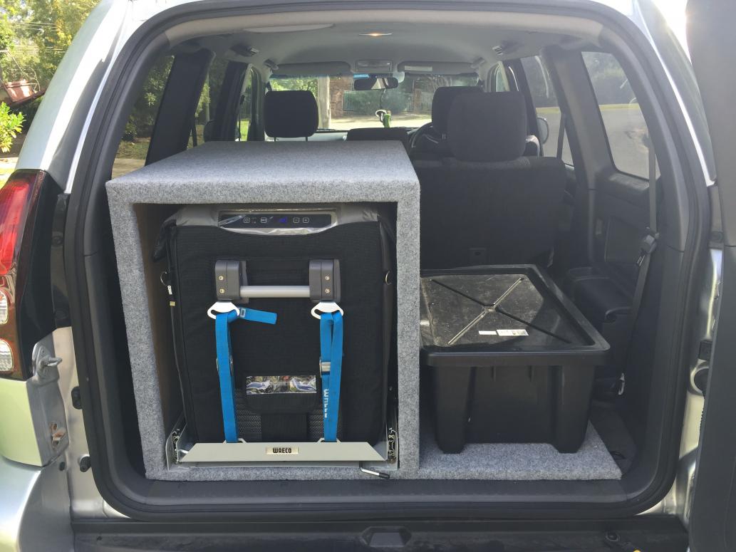

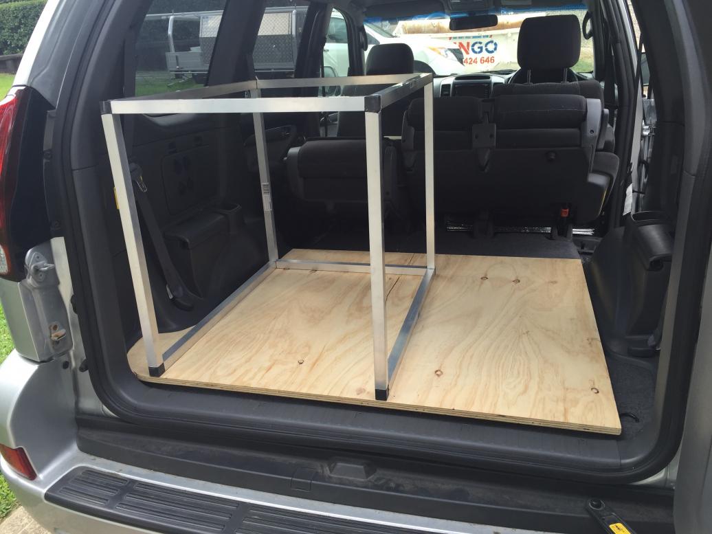

        • So I had a few free days and wanted to add a fridge slide on the rear. On previous Utes I never had a housing or compartment so every time you pulled out the fridge, everything would fall in behind it. So decided to make this. Could have done the whole thing out of 15mm ply and save a bit of money but that would have made it heavy. Instead made the base of 15mm and the structure out of aluminum then the top and sides out of 7mm ply. It's all very light until you add the fridge slide which is pretty heavy by itself. Worked out pretty cheap compared to something premade Plus getting the satisfaction of knowing I did it all myself

          It takes up a heap of room in the back but thats ok as we tow a camper trailer and most things except for food goes in there

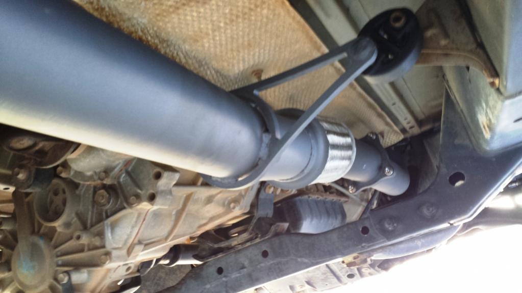

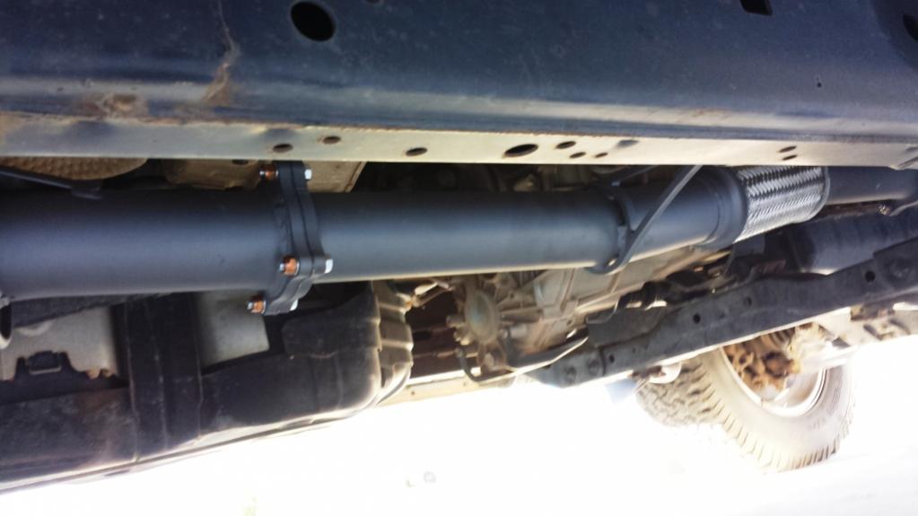

            • Had a 3 inch Redback exhaust fitted, What a massive difference both in sound and performance.
              Quality bit of gear.

                • With sound is it really noticeable as I don't want something noisy and causes a drone on the highway at speed. Any feedback you have?
                  • No drone at all, sounds great nice note and nice turbo spool up noise. The beauty of the redback system if you want to quieten it down you can just bolt in a muffler. No need though.
