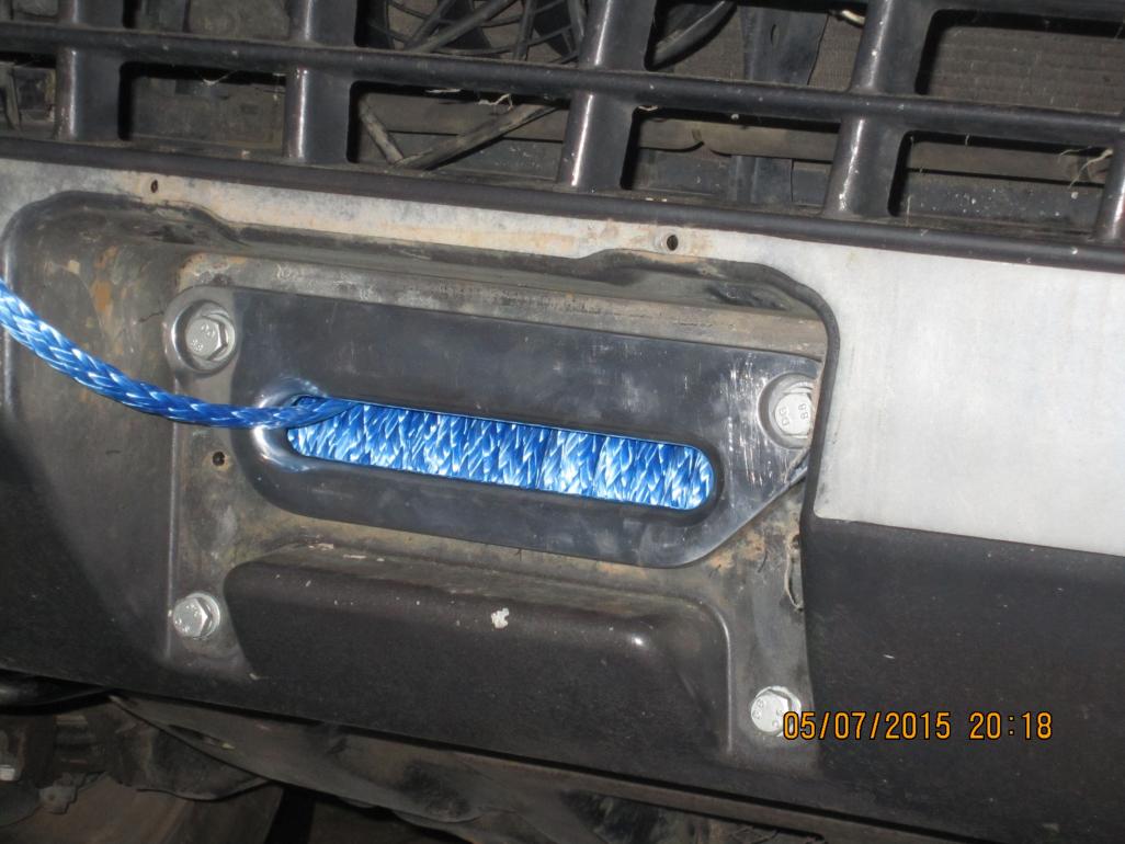

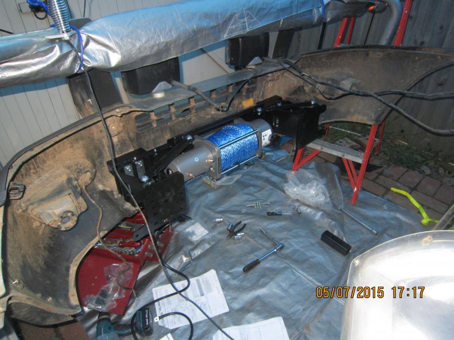

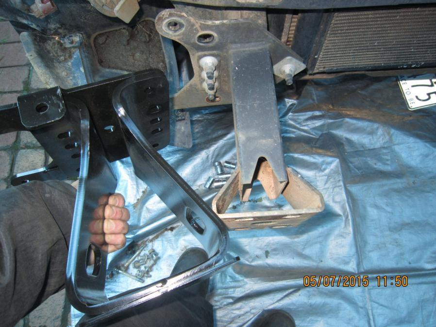

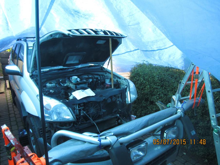

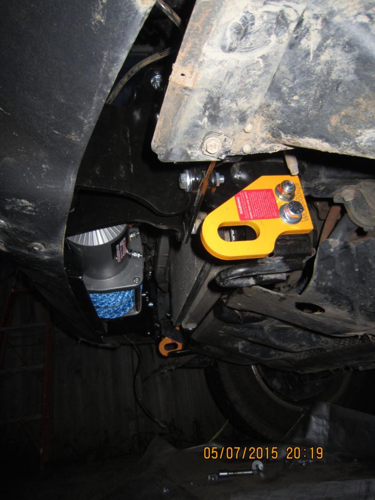

    • Winch on a Sovereign Bull Bar
      On My 2004 120 Grande - Fitted a 4wdSupacentre Grande MkIII Winch $500 to the Sovereign Bull Bar.
      This required replacing the bull bar mounts $300 (expired recall) and adding the winch cradle $200
      • Had to remove bull bar and old crush cans.
      • Fitted cradle to inside of bull bar bumper
      • Fitted the new crush cans to that
      • Bolted in the Winch (had to shorten two of the longer supplied bolts with the angle grinder)
      • Fitted the rest of the bull bar braces
      • Fitted Roadsafe recovery points
      • Mounted Bull bar back onto car
      All up it did take me best part of the weekend, although it was a slow start with the weather.
      The new brackets are really heavy compared to the old ones, which seem like paper.
      Havent tested yet, still got to wire up the control box (there was no way it was going to fit where the bull bar instructions wanted it mounted)
      Trip planned across the Simpson in August, so considering suspension lift next
