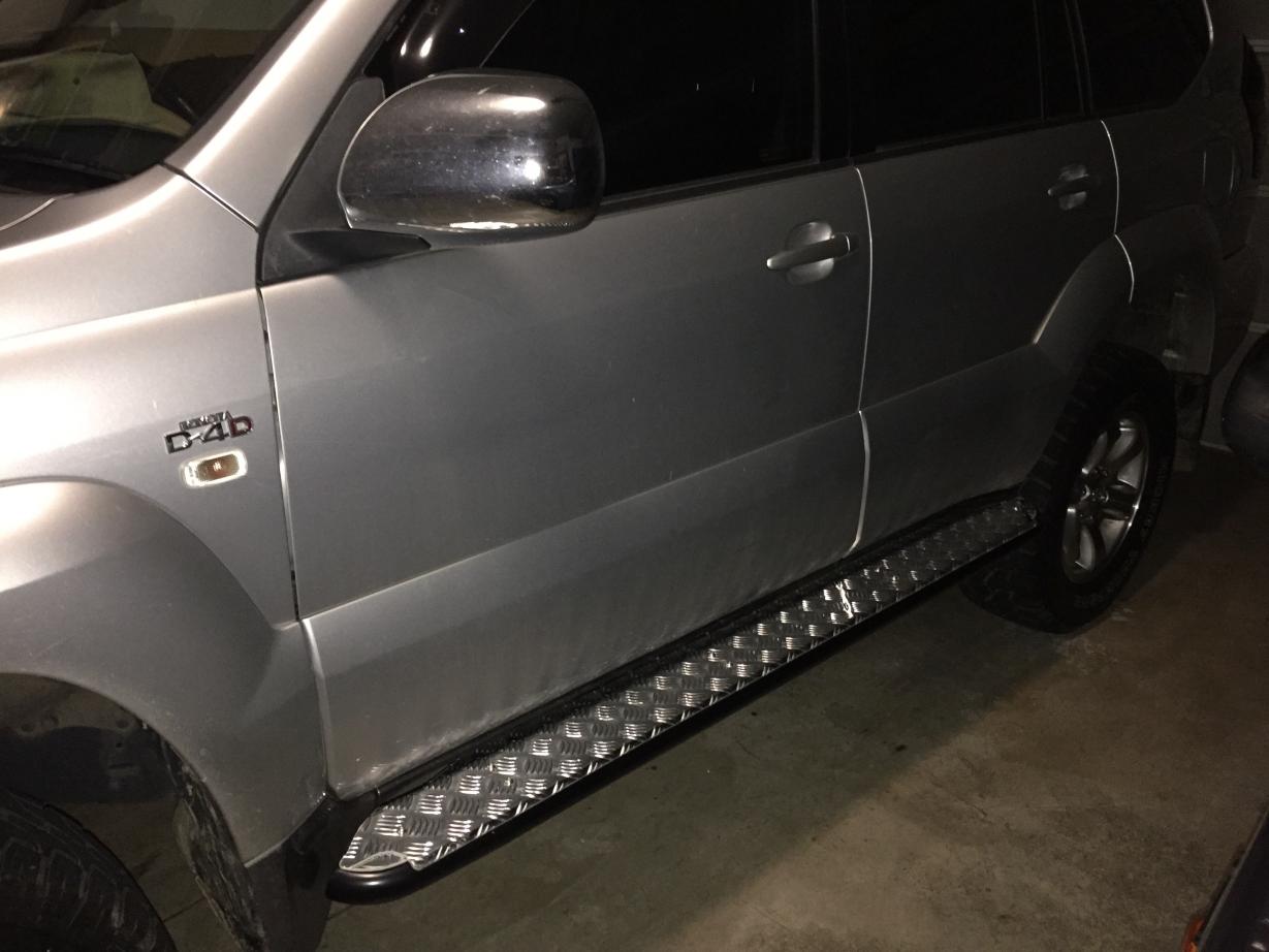

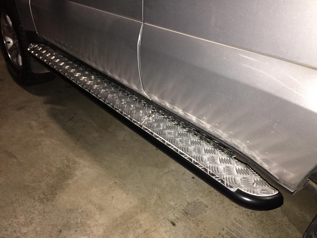

                              • Fitted up a set of TJM airbag compatible side steps today. Easy fit although the fuel lines needed a bit of manipulating to get them away from the front top step mounting bolt. Covered one of the lines with two layers of convoluted tubing just in case there is any movement by the steps in the future. In time I will make a bracket that will remount the pipes another 10mm further down.
                                I gained 85 mm from the ground to the step compared to the original steps. Also added a few KG's as the genuine are alloy and plastic and can be held up by my pinky finger. Also notice its just a little harder to get in the cab but that's a small price to pay for the benefits.
                                Sorry images are little dark as I just took them.
