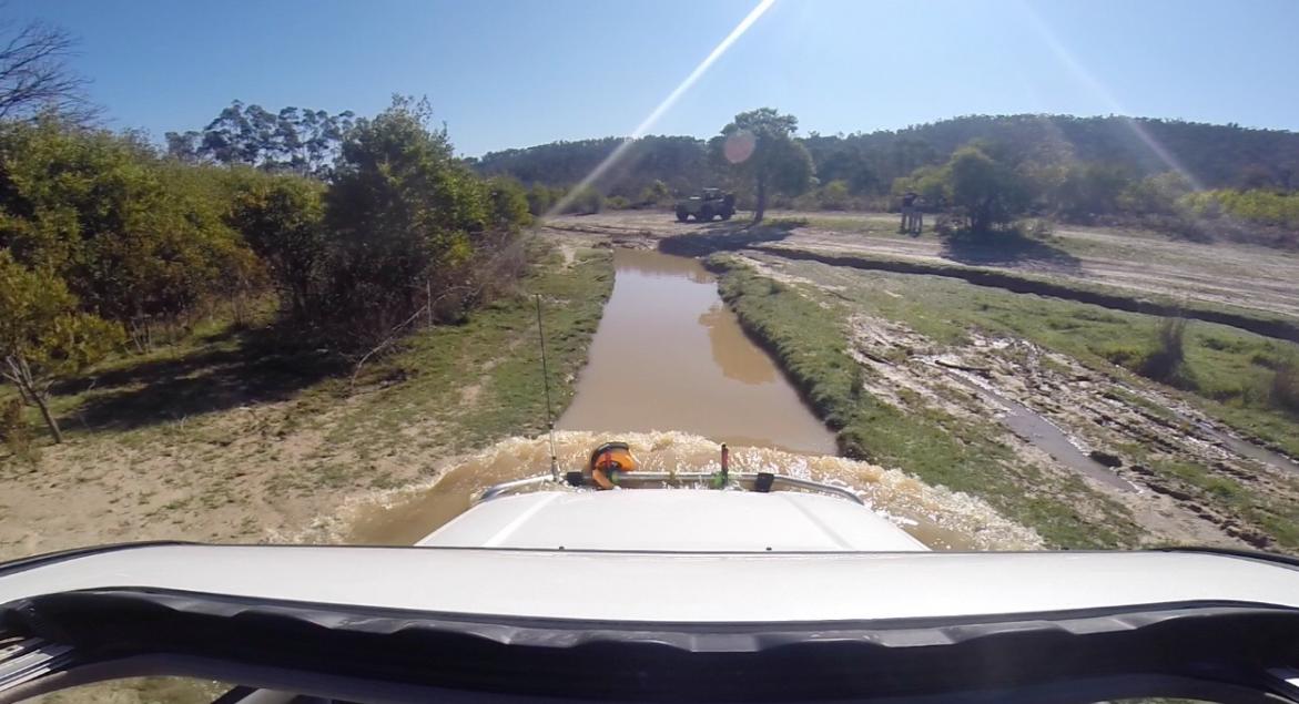

    • Stuffed up the transmission in a big bog hole- that won't be cheap to fix thats for sure....

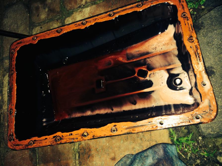

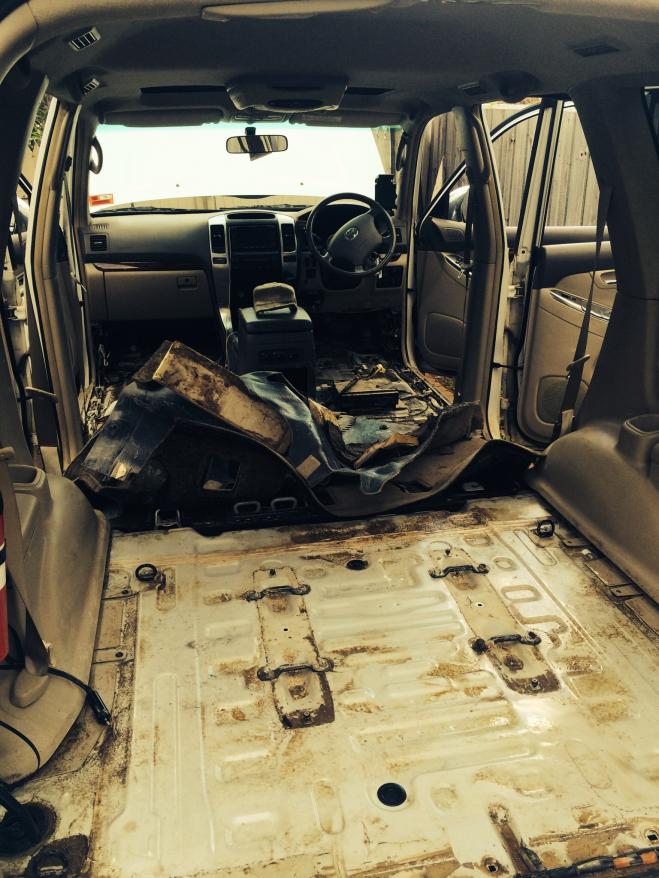

      • Great - well tranny almost back to normal now after a full flush, cleaned pan, changed filter and flushed through10 litres via coolant pipes. Hot level still low but cold level above high mark Wtf? over . Hot level seems to be the one to work to.
        Carpets all cleaned as is inside of car, it's never been this clean! Perhaps everyone should have fun in bog holes.
