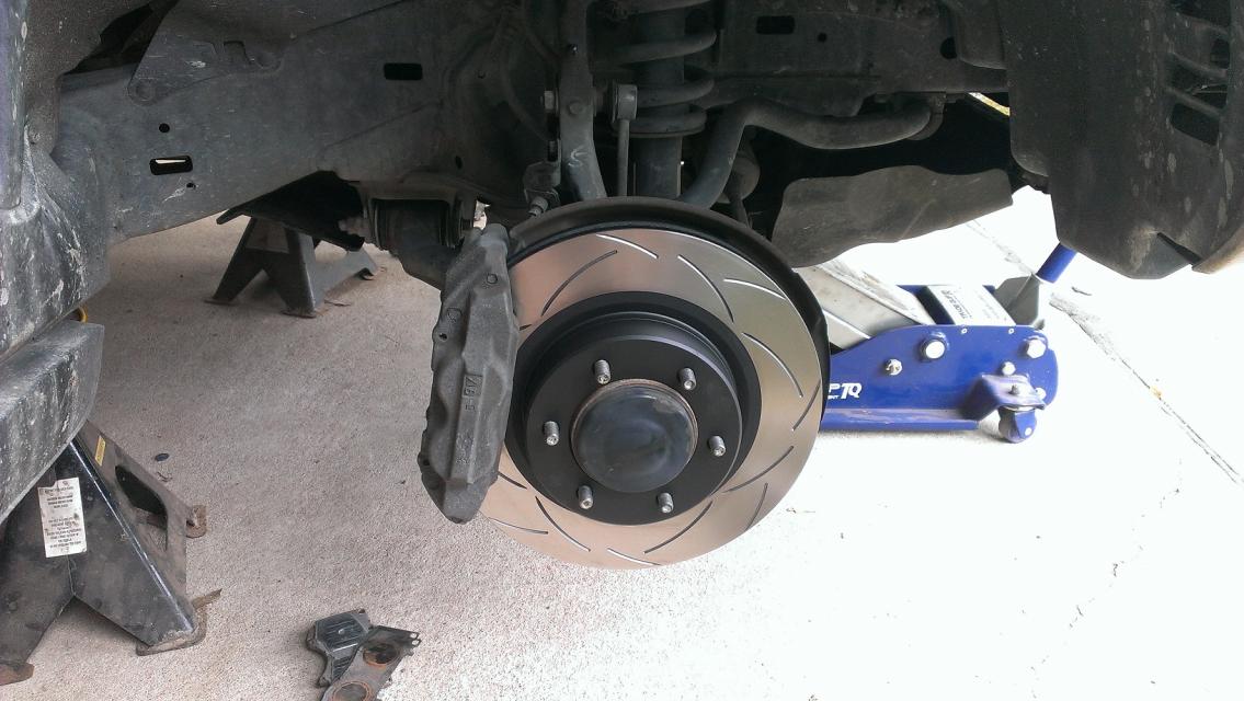

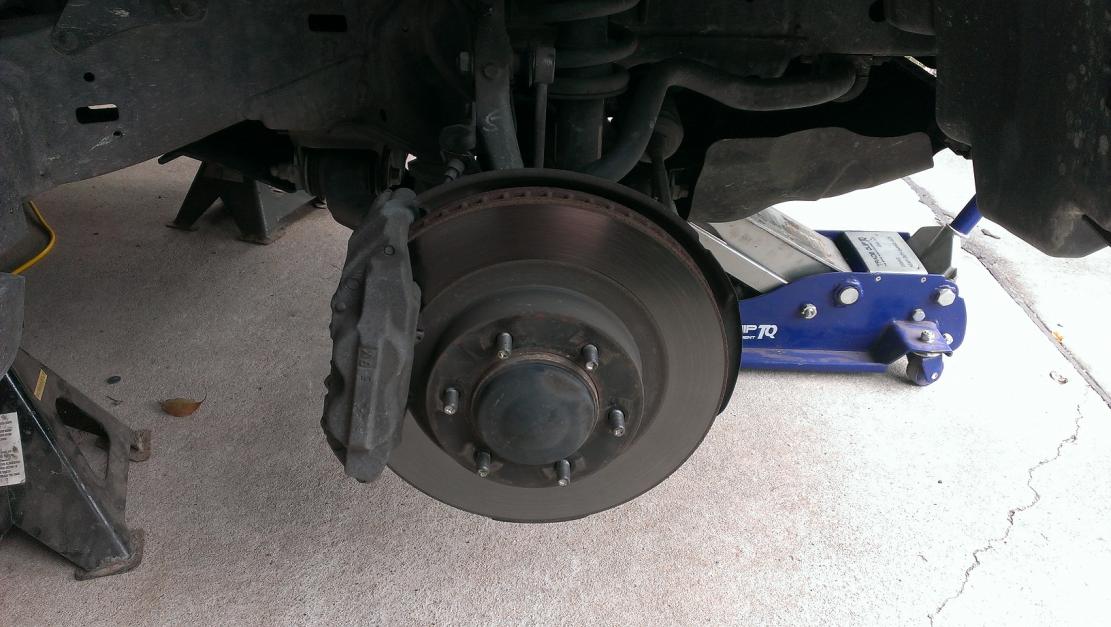

    • New DBA T2 rotors up front, Bendix brake pads all around and a helping of Toyota DOT 3 fluid. She does pull up harder now under heavy braking. The pedal still seems kinda soft like it use to though, but apparently the 120's were like that I heard?
        [ATTACH=CONFIG]21468[/ATTACH]
        [ATTACH=CONFIG]21469[/ATTACH]
        Shiney
        Hope you put that backing plate/shim back in with the new pads

                    • Originally posted by AussieAndy View Post
                      A
                      Shiney
                      Yep, sure did. Oddly, on the rear brakes only one pad out of four had a metal backing plate. Someone had been there before and was obviously not very thorough. Makes you wonder about some of the muppets working out there.....on vehicle braking systems! :-?
