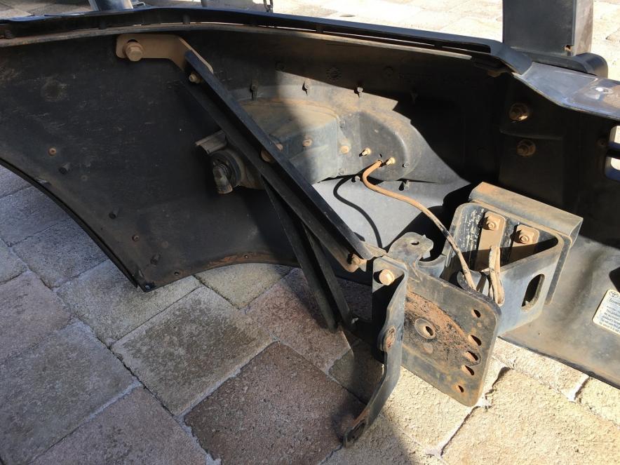

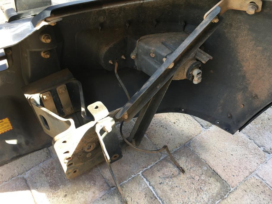

  • Yes, the recall brackets are attached. But there is another bracket that is not shown. Existing nuts and bolts for the bumper is insufficient to fit the bullbar. If the bolts and nuts weren't included, then the chassis pins would also be missing. You can buy a fitting kit from your dealer for about $100 which will have the nut, bolts, chassis pins. But you still need to find the missing bracket for each side.
    Missing side bracket
    Fitting kit

    • Damn, can i only purchase the side brackets and fitting kit direct from Toyota?

        • Cheers for the pics guys, is there a part number for just the side brackets?
          • does the fitting kit come with 4 brackets?
            • Originally posted by sr22232 View Post
              The side brackets? No.
              • Thats a pain, any idea of the part no for the side brackets or where I can source a pair?
                • Can't find a separate part number for it. Have sent you an email to make them.
