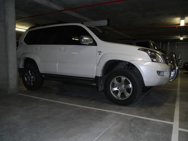

      Well, here it is... new OME suspension added!
      BEFORE:
      AFTER:
      We ended up going with the following option:
      Front OME884 coils + 9000 struts
      Rear OME896 coils + 60005 shocks (and OME661 stone guards).
      Before / After heigh measurements (double-checked by myself):
      LHF 635 -> 795mm
      RHF 635 -> 795mm
      LHR 745 -> 825mm
      RHR 740 -> 825mm
      Towbar height went from 370mm from ground to 460mm.
      Very happy indeed.

      • Re: OME suspension lift
        Nice lift there NTPRYCE!
        Love the clearance under the running boards now mate. Iam telling my Beloved that Prado's are made for suspension upgrades, "Just count the grab handles Dear" :wink:

                      Hoppy50, can you post a pic later of your rig on level ground (side on) to see what the rake is like with the 883s up front and 896s on the rear?
                      We were going to go this way but then changed to 884s up front instead. We have a sovereign bar up front but no dual battery. We're very happy with the lift, ride and look. I'm sure you will be too, but I am interested to see what 883/896 might have looked like. Cheers. 8)
