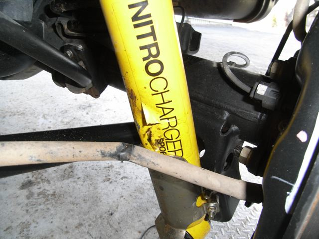

      [attachment=1:18dziein]RIMG0007.jpg[/attachment:18dziein]This was the result of a piece of metal on the road. Unfortunately it just clipped the inside front wheel and punched a hole in the rear left OME. Damaged the handbrake cable as well. We had only done about 1000kms on the new OME's :cry:
      [attachment=0:18dziein]P8130426_2_2.jpg[/attachment:18dziein]Had a replacement brought in from Tamworth, on the road again two days later. Spent a month Sydney-Birdsville-Flinders Ranges-Sydney. OME performed very well, extremely happy.
      • Re: OME suspension lift
        What a bugger. Pity the stone-guard wasn't a little higher or the strike was a little lower . Did you get pics of the chunk of steel you hit? Did you misjudge the clearance or not see it?
        Glad to hear the trip continued went well thereafter.

            No photo of the metal. It was about 30cms long, 2 cms wide and curved like a half circle. It just clipped the inside of the front tyre and flicked up... I thought Id managed to miss it .
