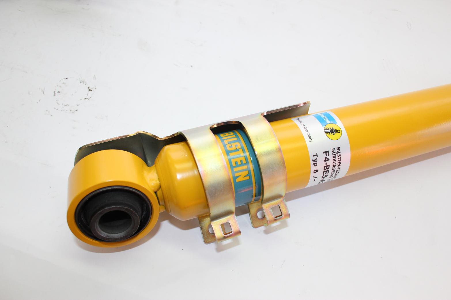

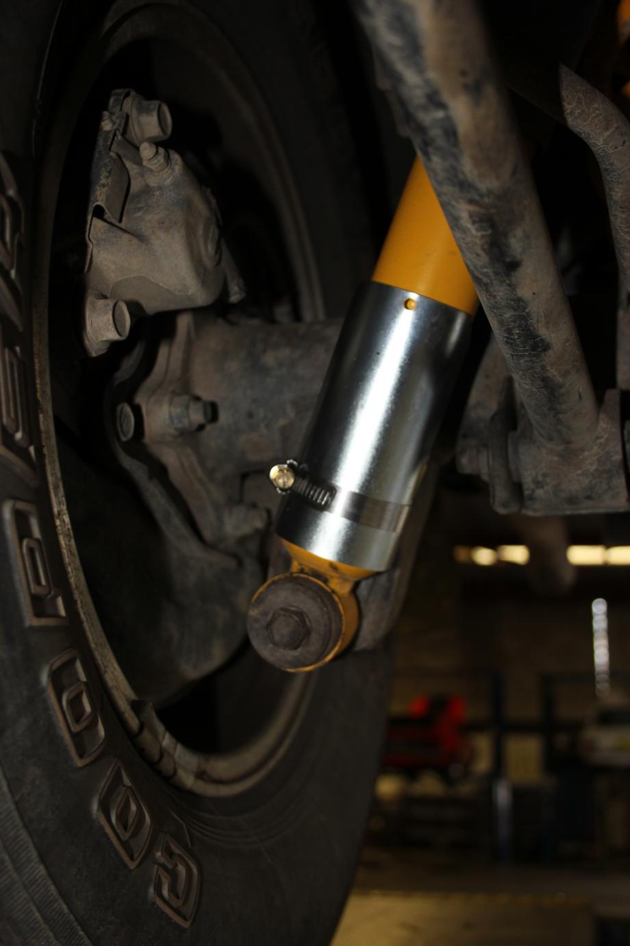

        I fitted these covers from Bilstein to mine when i did it & i fitted some sticky Counter Top dots behind them to space them for air to get in around them & also to stop the cover scuffing the shock badly.

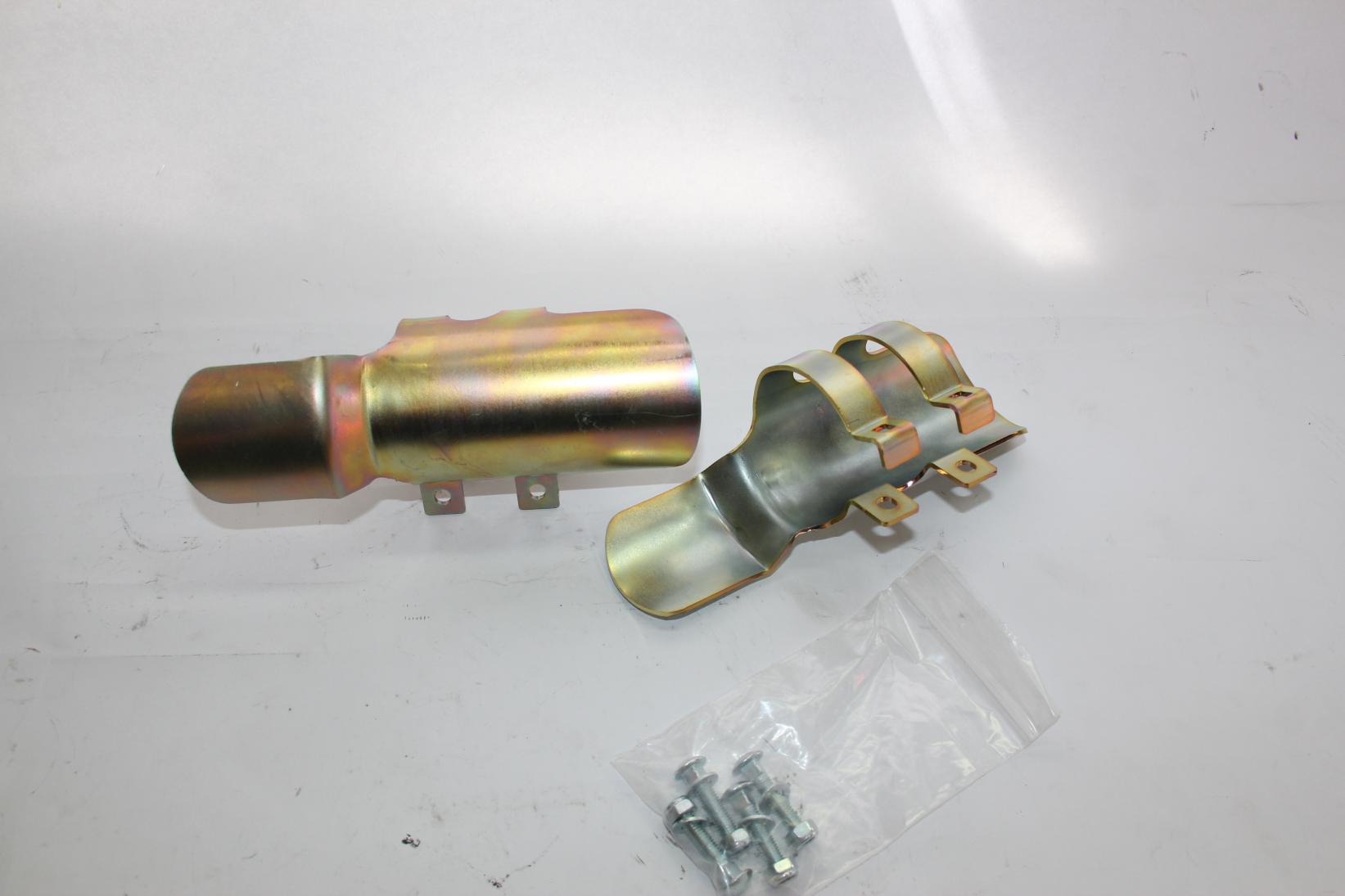

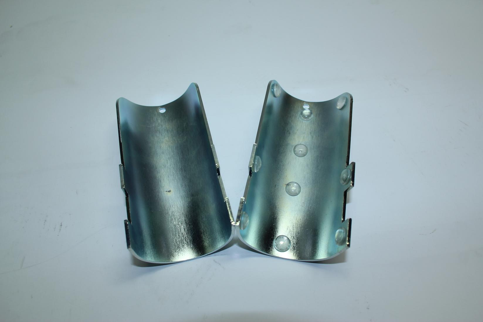

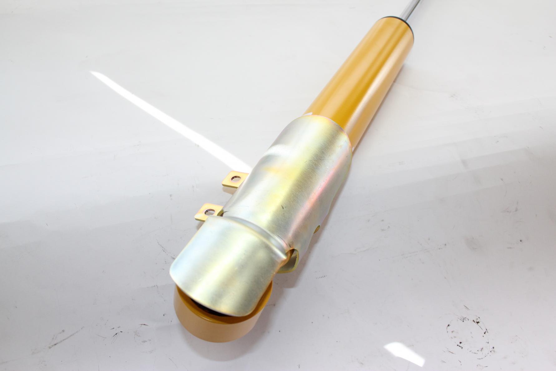

        Then i found these OME one's that i like better as they cover the lower bush and eye also.

          I have the Bilstein guards - they look after the bolt and lower parts of the tube but the rest of the tube is pumbled to the max. Some new Billies going on next month all round.
