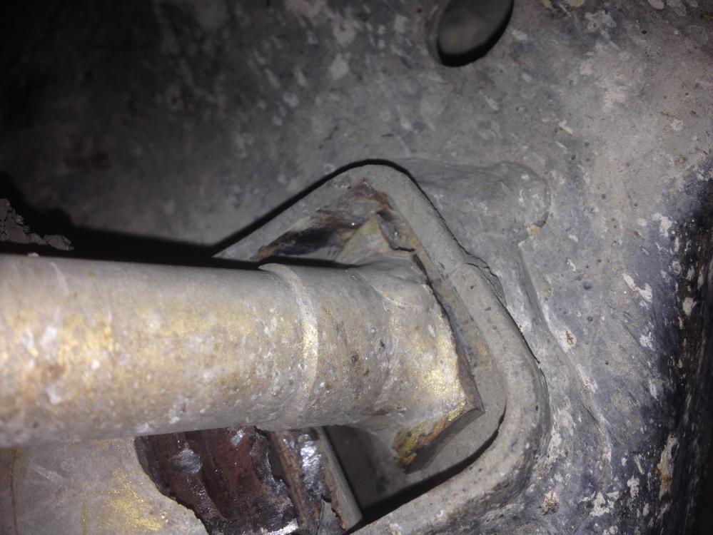

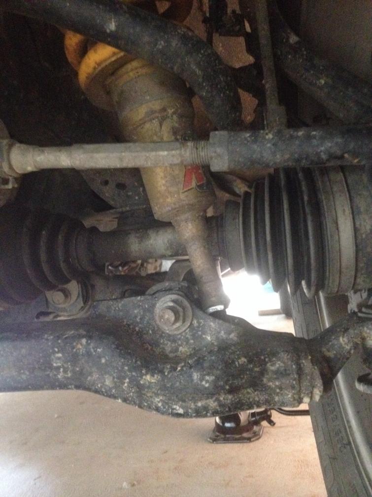

    Im running 2 inch TJM XGS front struts. I noticed a loud squeak had developed and a harsh return over speed bumps. On further inspection I noticed the passenger side strut has snapped clear at the bottom eye.
    Is this a common fault or random occurrence?

      I had it happen with ToughDog. I blame it on tensioning the bottomm bush while the car was still on the hoist and crap workmanship with the strut. I had a fillet weld of barely 2mm. Mine was out of warranty so I had to throw the defective unit through the glass window of the fitter. Fixed the problem. Worth talking to TJM. Can you post up a close up pic to show the weld?

          It doesnt look like it is the weld the gave. So you think that the bottom bush should only be rattled when the car is lowered. I installed them myself and I think I tightened in on the hoist.
            I have seen it before on a Hilux it was a Bilstein strut........Pretty sure there was a photo of another strut snapping posted up on here somewhere a few years ago.........
            I have done 5 or 6 front strut changeouts for myself and mates rigs and always check the welds before installing as the Bilstein strut had barely enough weld IMO and i'm a Boilermaker by trade so I have some idea what to look for.
            I don't think tensioning the strut from new while still on the hoist has much to do with it IMO that would only twist and destroy the rubber bushing insde.........the ferrule that is pressed in for the bush eye is usually a little longer/wider than the outer where the stut is welded to and so would receive all of the force and not the outer part.....
            I'd be looking at your welds to be honest.

                  That has broken in a different place. I will see if I can find the pic I took of mine.

                    Your right mjrandom. That is definately a faulty weld break. It seems strange that mine snapped the eye ring.
                      It was yours I was thinking of MJ.........That's just rubbish quality mate..........Unfortunatly it would not be the only one they made like that I would bet.
                      Just as a matter of intrest the OEM struts seem to have good quality welds from what I've seen.

                            I had one snap at the eye, TJM strut. Lucky it was still under warranty at the time. They put a new set in and no problems for the rest of the time I had the 120
                              That TJM strut has the old style bottom bush outer sleeve. the failure is due to metal fatigue & not poor welding in this case.
                              The newer style TJM struts have a much larger outer sleeve to prevent the flexing on the outer sleeve.
                              mjrandom's tough dog failure is due to a welding problem
