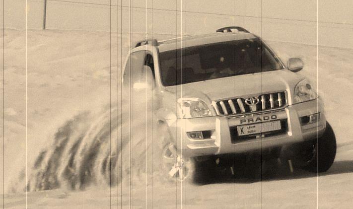

    Hi,
    just installed a 2" Dobinsons lift on my rig, whats a good allignment setting to dial in after the lift?
    It is a daily driver and weekend desert4x4.
    Any ideas of an online website that sells good quality aftermarket rims for the Prado in Aussy/USA? after the lift the tyre/rim looks tucked in. I dont like the idea of spacers, thinking of a different rim with a proper offset to get the stability and looks back.
    What offset/backspace would you guys recommend?
    thanks in advance...
