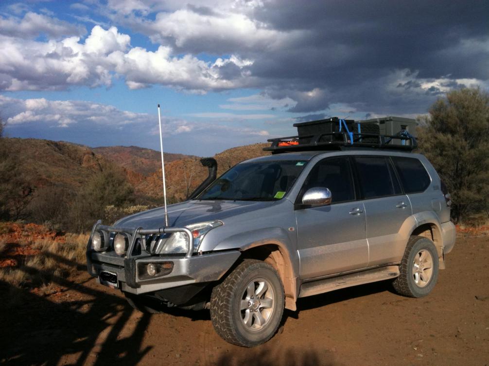

    I have 275/65/17 Bridgestone D694's on my 120 and you can barely tell the difference just by looking at them so I wouldn't worry about how they would look on a standard Toyota alloy. If you do go the 275 you may need a spacer for the spare if yours is on the rear door.
    Below is a picture of mine with the 275's on it, I don't have a close up picture but it will give you some sort of indication how they will look.

        Cheers guys. I will definitely stick with the better known brands, just wanted to know if the load index will have an impact on tire life, I was not sure. Justo77, the tires look like a good fit in the rear, the fronts would probably rub against the standard front bumper under load. Why have tire prices gone through the roof?
