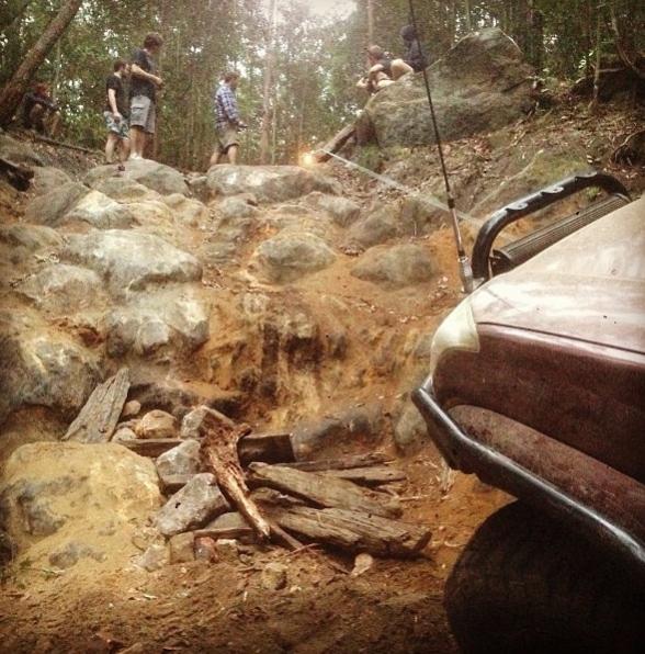

                PS - The fourth pic, winching up what looks like a wall.. is that the top of 6 Stager? I was planning to try that track soon but must admit that section gives me second thoughts...
