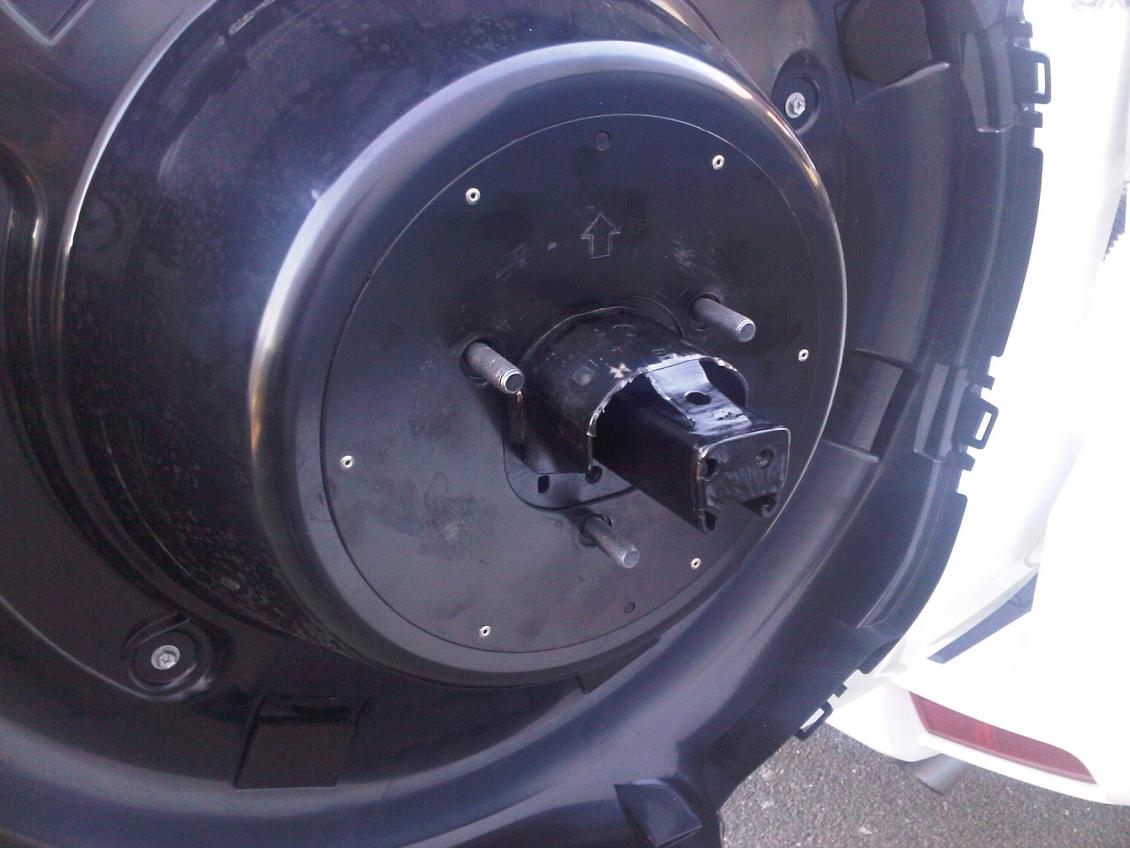

        Thanks guys. I was down the garage today to swap the wheels over before final delivery. I didn't have time to check the spare but it is the same mould for the GXL and above models as it has a panel where the camera would go. I went with Speedy Chariot (Black) in the end. This has a 5 mm offset difference over standard, so I may or may not have a problem still. The outside wall of the tyre should be 5mm further away from the face of the back door. We'll see what happens!

          Well the Speedy Chariot rim won't fit on the WOD carrier - the centre hole isn't large enough. I will need to modify the centre stub (that just stops the centre of the fibreglass cover from rattling, by the looks of it).

              Good point! I did check it all out and the slight difference is within spec on the wheel offset.
              As for the wheel carrier design, Toyota have included a beefy looking centre cone to help the user slide the spare wheel up to the 3 wheel studs without difficulty. We'll do some delicate surgery with the angle grinder and welder to do a bit of Jenny Craig to skinny it down a bit.

                Here is the result:
                I can't take any credit for the work. It was others that did the modification. If anyone is interested I can find out what was used.
