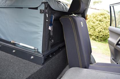

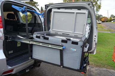

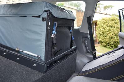

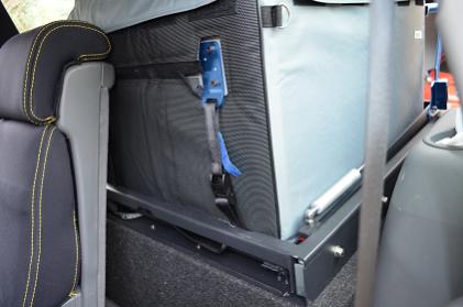

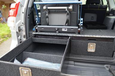

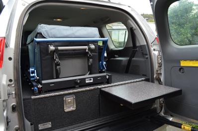

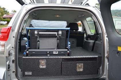

                          Waeco CF80 and Drifta Drawers
                          Hi, hope the pics will help.
                          As you can see, all fits fine.
                          Will Add more.
                          Regards, Ian

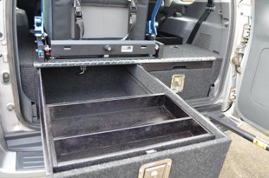

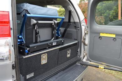

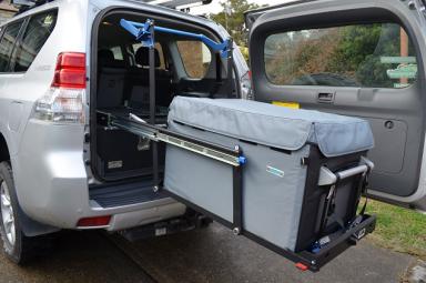

                            More pics of the fridge and drawers.
                            Fridge slide is MSA brand and drawers system is Drifta.
                            I had the guys from Drifta install everything and couldn't be happier with product and service.
                            Same day the did the Prado, I had them install drawers to under the bed of my hardfloor camper.
                            Regards, Ian
