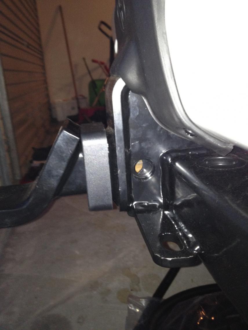

    I installed a genuine Toyota tow bar to my 150 Prado 5 door today, everything went well and I thought the job was finished until I inserted the hitch tongue into the receiver. It seems that the hole for the locking pin in the tongue is drilled about 10mm too short, therefore preventing the locking pin passing through the tongue.
    I have contacted the dealer I purchased the bar though and am waiting a response from them, but I was just curious if anyone has seen this before. The tongue I have is only drilled with 1 hole on one side (obviously the one that is too short) and the hole on the other side appears to be marked by the laser cutter, but not actually cut out.

    I have seen this before. It was not that the hole was in the wrong place, it was that the tongue was too short. The tongue for Nissan Pathfinders is made shorter than normal due to the location of the spare wheel. If you try this shorter tongue on just about any other vehicle you will find that the hole does not line up.

      That silver trim that makes it look pretty isnt in the way is it ?? Just looking at the picture on the angle you have taken it, the distance between the silver surround and the metal plate looks about the same distance the hole is short stopping the pin going through ?? Just an observation thats all. If you remove that silver surround do you have any more leeway allowing the hitch to go in further ?? Cheers Steve
        The silver bit is just a trim that sits over the end, barely a couple of mm thick. You need a different hitch to suit the towbar.
          Looks like a Friday afternoon towbar tongue. The fact that there is no corresponding hole on the other side makes you wonder what's wrong with the rest of it.

                My initial thoughts were that it was something to do with the trim cover, but as Mjrandom said, its only a trim piece that is a few mm thick and presses up against the front of the reciever. I did atrempt to pull it off but it is held by some serious plastic lugs and I doubt I could get it off without destroying it, so i have left it until i here from the dealer. As others have said i am fairly confident its the wrong or a faulty tongue.

                            Ok, sorry for the delayed update...
                            It turns out they shipped me the wrong tongue, swapped with the correct one and no surprises, it fits!
