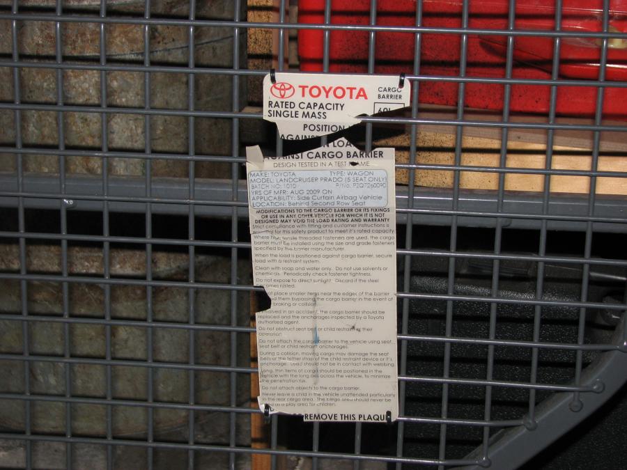

        I recently bought a secondhand cargo barrier for my 2012 Prado and are not sure how the bottom brackets are fitted as there are no threaded hole in the floor.
          What type of barrier is it and did it have the fit kit?
          [b]Rob[/b]
            I have fitting instructions for a Milford barrier.
            [b]Rob[/b]
              Thanks for the reply, I tried to attach a few photo's with no success the best I can make out it is a toyota barrier but I am sure, but it does say it is a 2009 on, I think Iam just going to put a few Tech screws into the boot crossmember
                Org2 ..I personally hate that Charcoal colour. If you want to make it smick before going in the car, get it sandblasted and powder-coated black. It's visually more appealing and eyes look through black mesh easier than any other colour....think Crimsafe black barriers and black insect mesh screens/doors etc.. I think yours is made by Milford, just badged up by Tojo with there brand! I got my $90 barrier done like above ($80) and it really looks the part with my black metal lifestyle rack. I'll try and post some pics on that thread. So pleased I got it powder-coated, best $80 I ever spent. Like Hutch said a fit kit will set you back @140.
