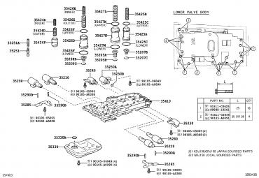

    So I went and bought my service parts today and thought I should also quote up a trans service. Well apparently Toyota say that my vehicles automatic transmission is not fitted with a trans filter?? Has anyone heard of this? This would be the first auto I have seen without a filter or strainer or gauze that is serviceable.
    Maybe they say that because they also claim that we never need to change the ATF but we all know this is not true as I had to change mine at 120k as have many on this forum.

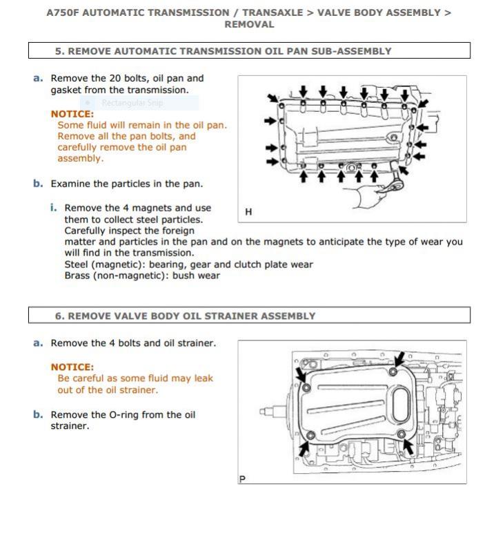

    I've attached a snip-it from the Prado service manual. I've never had this particular tranny open but I also assume there is a filter/strainer. The manual confirms this.
    Just remember these Autos have special 'Totota WS' ATF inside.

      I thought this was very odd, but even if it's a sealed for life unit they should still list a filter as what if a mechanical failure had happened? Any ways I will check with another dealer about parts. Thanks
        Try this part number
        Or better still buy a Cooper filter on Ebay for a fraction of the price if Toyota say it doesn't exist.
