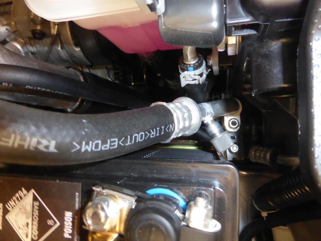

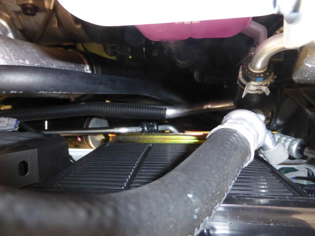

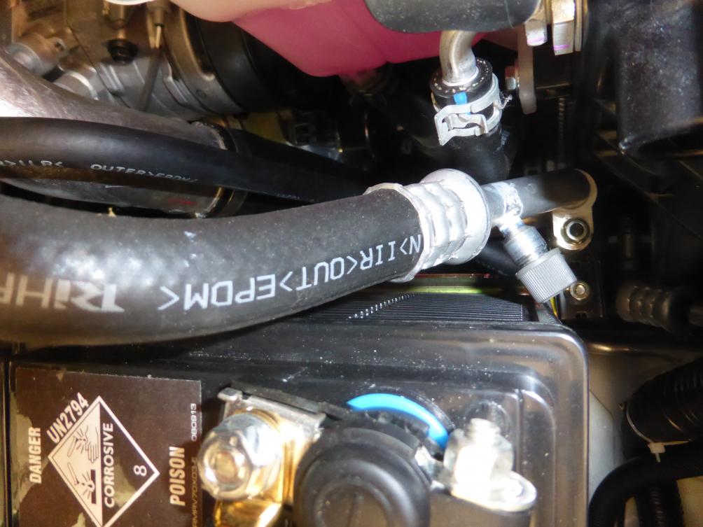

    Recently fitted a cheap ebay tray (http://www.ebay.com.au/itm/291177407037) to a 2014 GX (not GXL) and mounted a huge 305mm battery with little difficulty.
    The tray set came with a little separate bracket which shifted the aircon pipe about 15mm towards the middle of the car with very little effort. The pipe now still has 5-7mm minimum clearance on it's full length with the plastic cap of the refill being the tightest spot. As the pipe is securely fastened and the battery is anchored all around the base and on the top there should be little chance of rubbing.

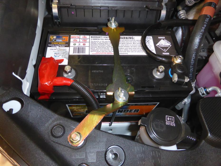

      hey foxpro, can you post a pic of it with the battery mounted?, the battery clamp looks like it offers some support to the top of the battery unlike the ARB kit
        Hard to get a single good shot. Here are some snapshots.

        Battery is this: http://www.supercharge.com.au/allrounder-mrv70

          thanks, I was after that top shot. It looks like i nice clamp onto the top of the battery.
            I think it it way better than the original Toyota plastic tray w/o top bracket on the other side of the car. If I were to worry about battery movement I'd be more concerned about the original than the aux.
              Looks just like a Piranha setup almost down to the last nut and bolt. But costs a lot less.
