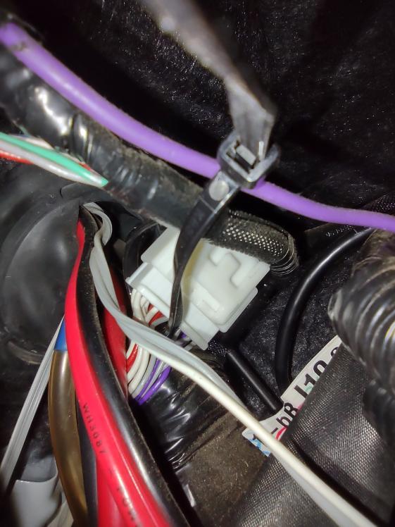

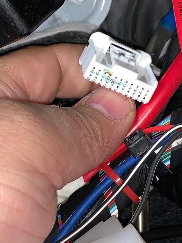

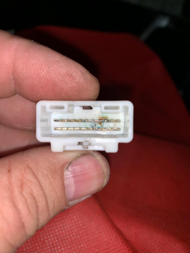

              Unfortunately wires were pushed through the large grommet surrounding the wiring loom nearest the steering wheel and not sealed adequately. After washing the engine water seeped along the loom and onto the plug. As well as the engine turning over the brake lights would come on when parked and nobody around. The plug has a number of wires going into it but the opposing plug just seems to be a type of blank with pins. Iv'e cable tied it upside down to prevent any further issues as well as silicone the offending wires. Click image for larger version
