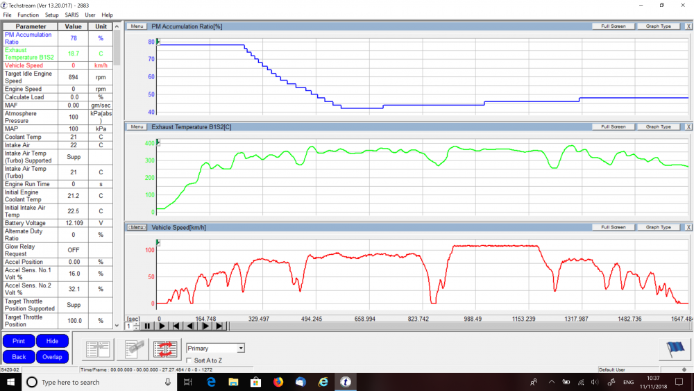

            • If anyone is interested here is a graph of the soot % recalculation from my not updated yet Prado.
              It had covered 160 Km's since the last regeneration and you can see the % coming down fro 78% to 42% without any DPF rise in temperature or as far as I can see any other parameters changed.
              Please ask if you would like to see graphs of any other parameters that may be relevant.

                  • Originally posted by JohnLynn View Post
                    Click image for larger version  Name:	Screenshot (58).png Views:	1 Size:	220.7 KB ID:	742089
                    The Exhaust Temp you are showing doesn't look like the temp in front of the DPF. It looks like what I see further back up the pipe for the speeds you are showing.
                    As the DPF saturation declines to around 40% I'm seeing low-mid 500C temps. Once DPF drops below 40% I'm seeing the temps rise to 600-700C.
