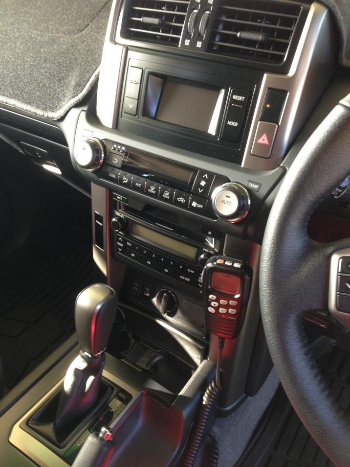

          I have installed a icom 440n under front passenger seat, no problems so far....
          2012 Graphite Kakadu, bush pin striping, BFG's and everything you can think of !!!
            Had no problem with mine....

              I've got the GME TX3540 installed in my VX, and haven't had any issues so far. I did read the warning, but (naively or otherwise) left it in the hands of the installers.
              P.S. Haven't tested out the Aribags yet... and hoping not to have to!
              2011 Crystal VX 150 | ARB Deluxe Combo Bar | Safari Snorkel | IPF 901XS Driving Lights | Cooper A/T3 265/60R18 | Hayman Reese H/D Tow Bar | GME TX3540+AE4702 UHF | Warn XP9500 Winch.

                        I bought the GME 3540 and mounted the base unit on top of the glove box "casing" where that stupid little business card holder thing is. Just grind of a little of the plastic moulding bits and it fits perfect, then fit the remote socket for the mic down near the drivers left leg and screw the mic bracket to the dash just to the right of the satnav screen. works a treat and you can jst unplug it ane put the mike away when not in use. Buy a cheap remote speaker and screw it to the top of the left foot foot rest. its out of the way and you can hear it perfectly
