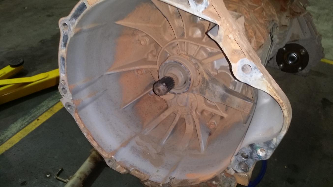

                OK - reviving this thread as I was out on a 4 day escape to Fernhook Falls, Broke Inlet, Fish Creek, Moores track, Coodamurrup Beach when my clutch failed.
                Get underneath to find the dealership who rebuilt the engine had left the backing plate off......
                Ring said dealership and they are debating about whether leaving it off would cause premature failure, they think 150k it pretty normal for a clutch (which I cannot really argue that point as a clutch is a variable consumable......
                (I did 2x creek crossings (500mm) and fair amount of sandy track / beach work on the trip , there had never been ANY signs of clutch wear prior - and we towed the horse float only the weekend prior.
                Dealership is prepared to strip it down at a reduced rate and inspect, then depending on what they find perhaps cover the lot or charge a lower rate.
                #thiscariscursed

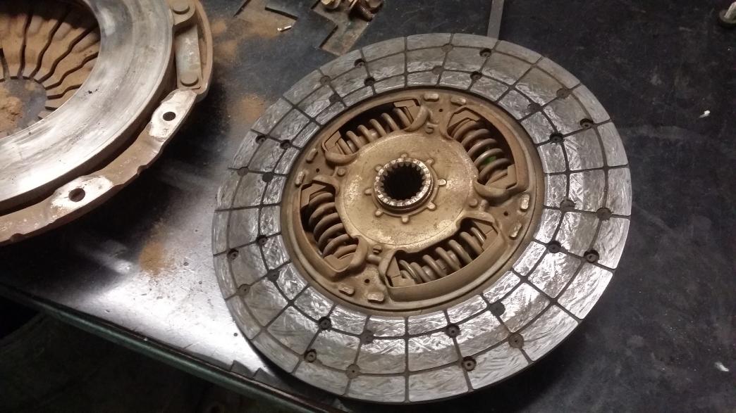

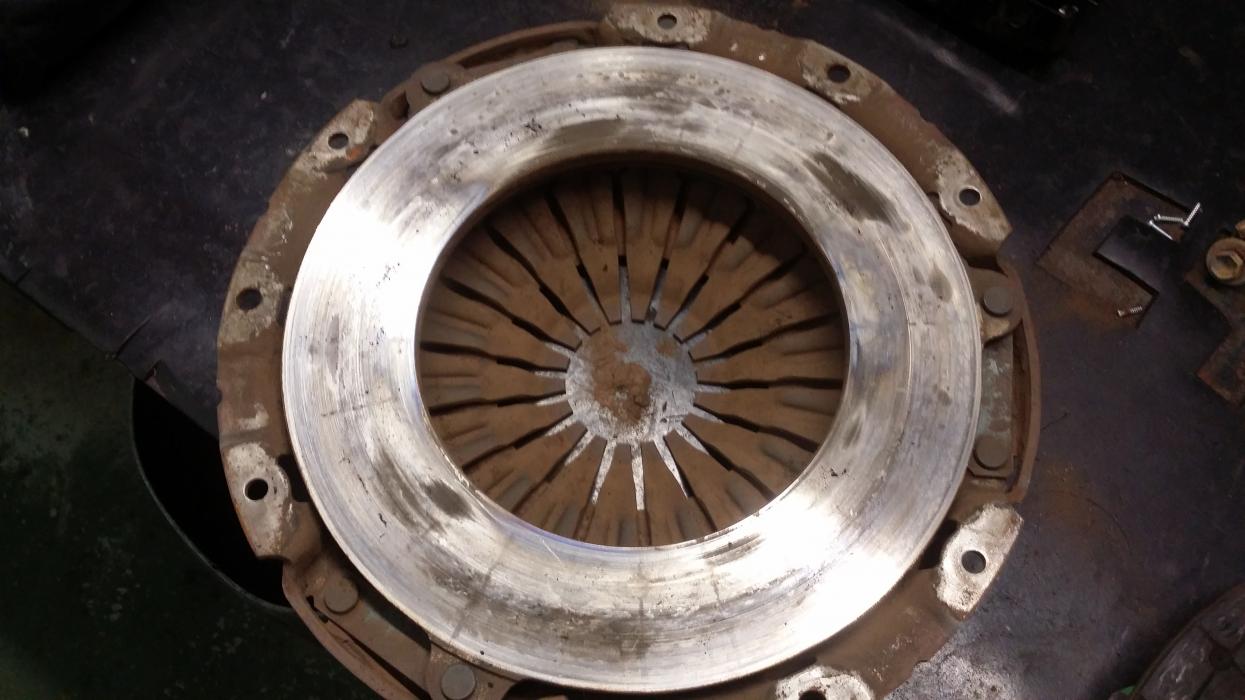

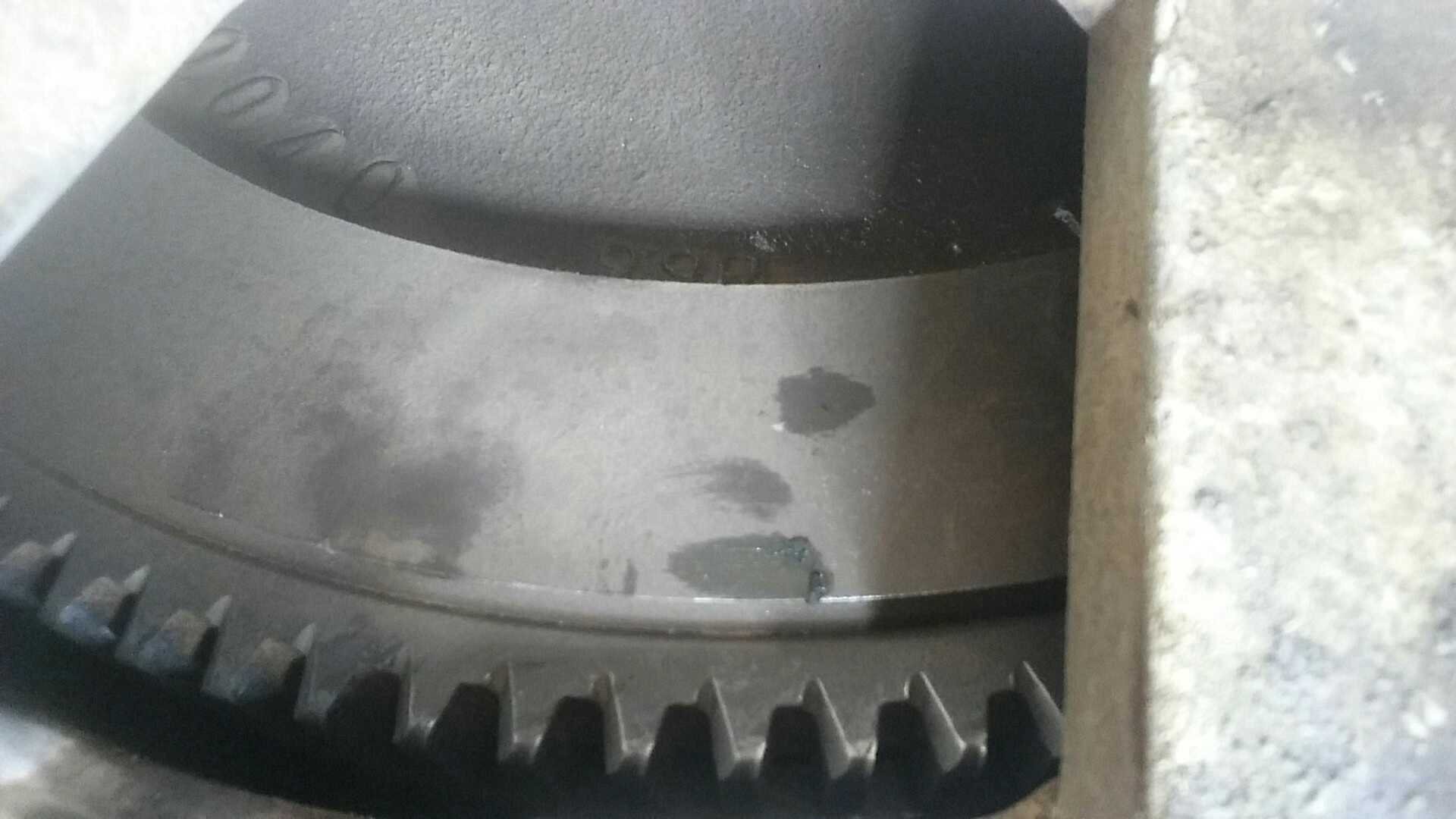

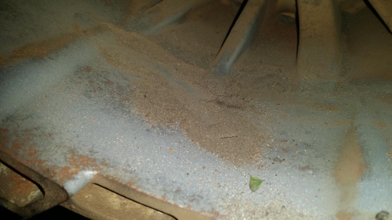

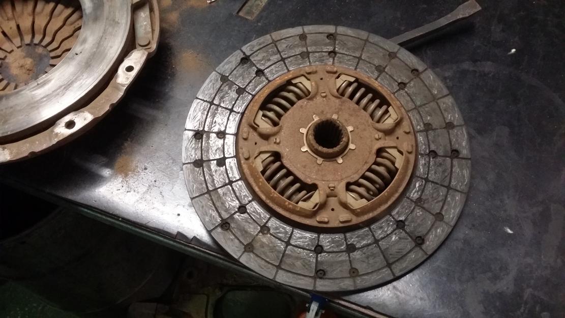

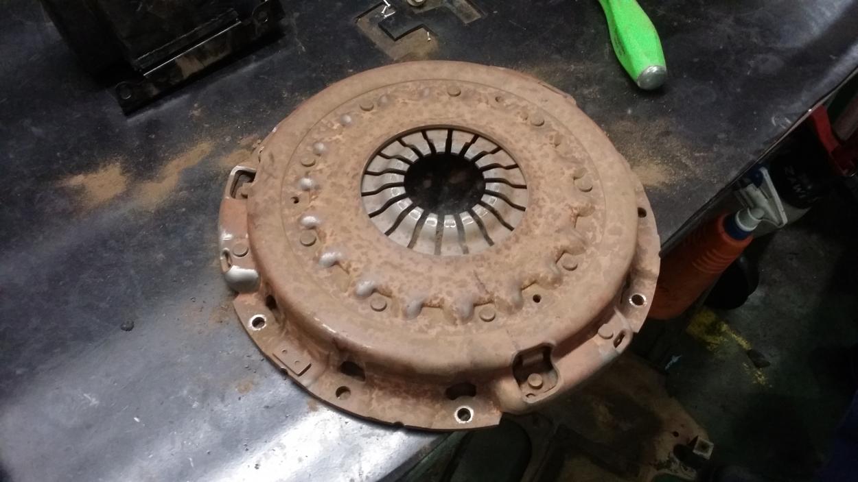

                  My clutch....
                  shodown

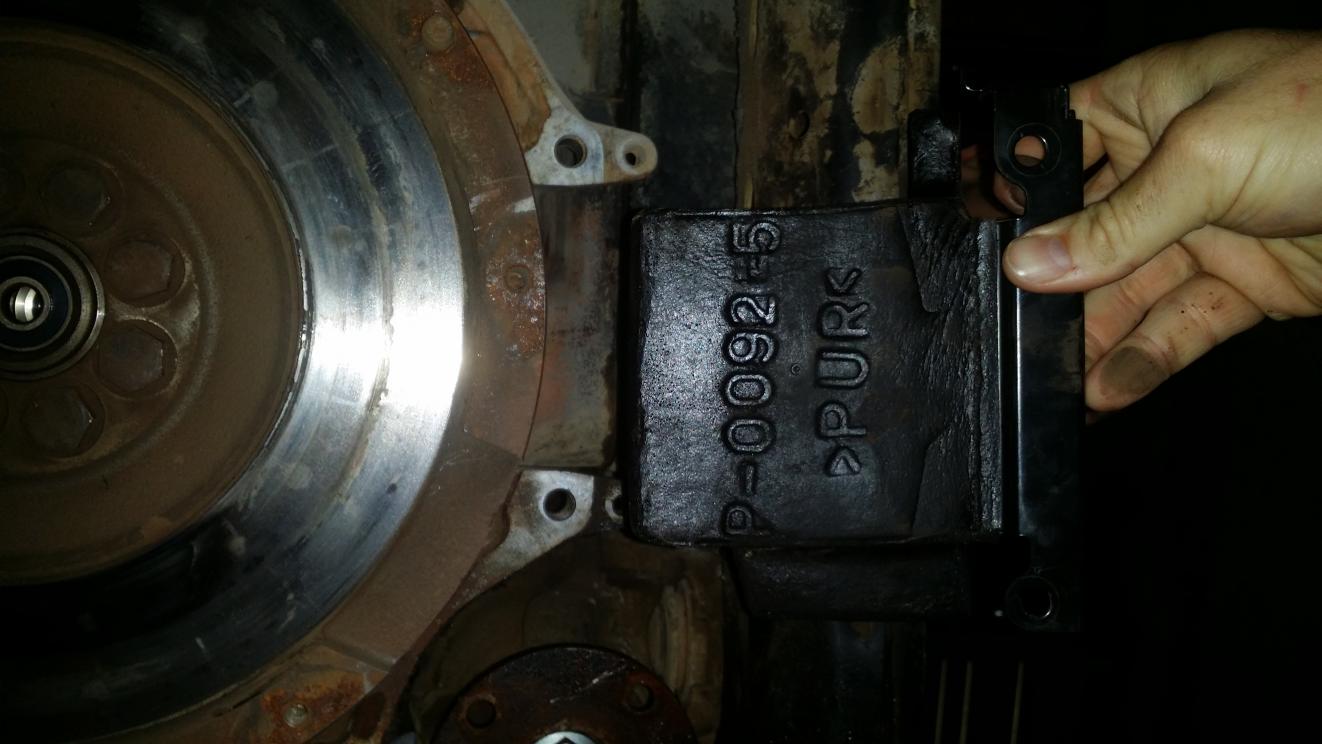

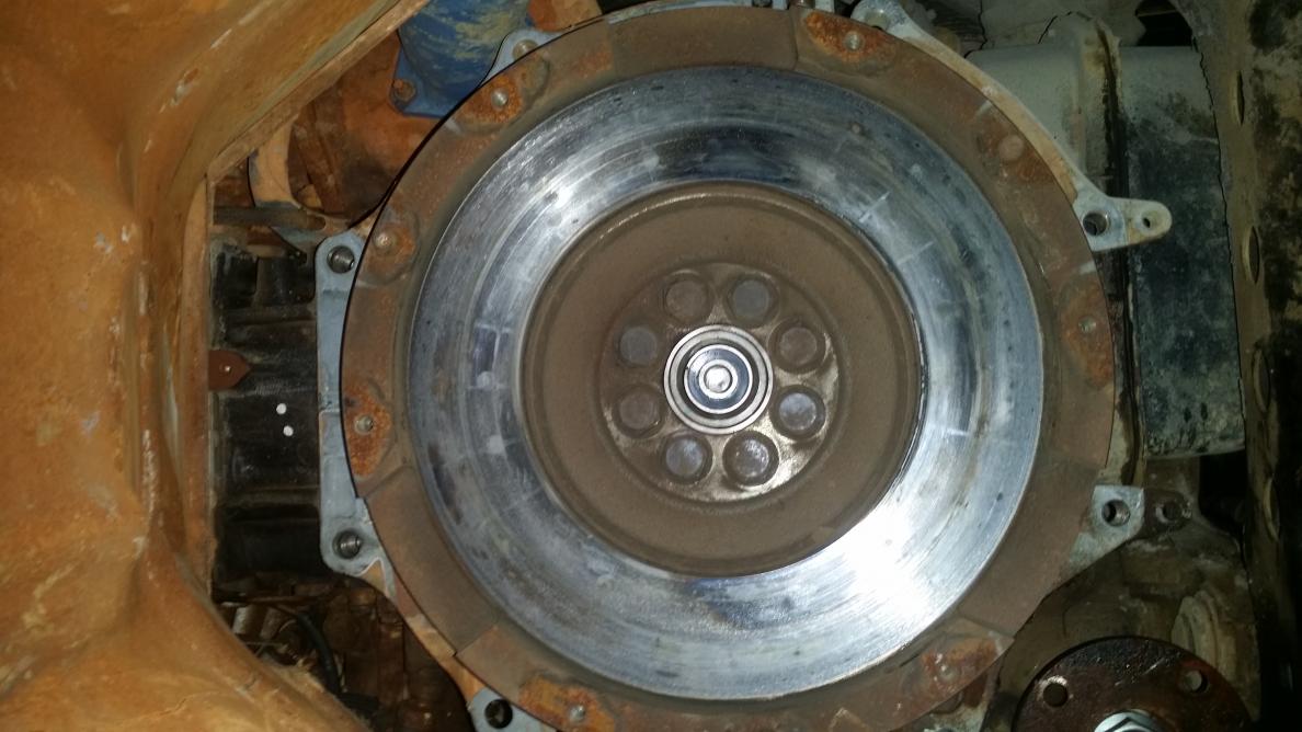

                  • #69

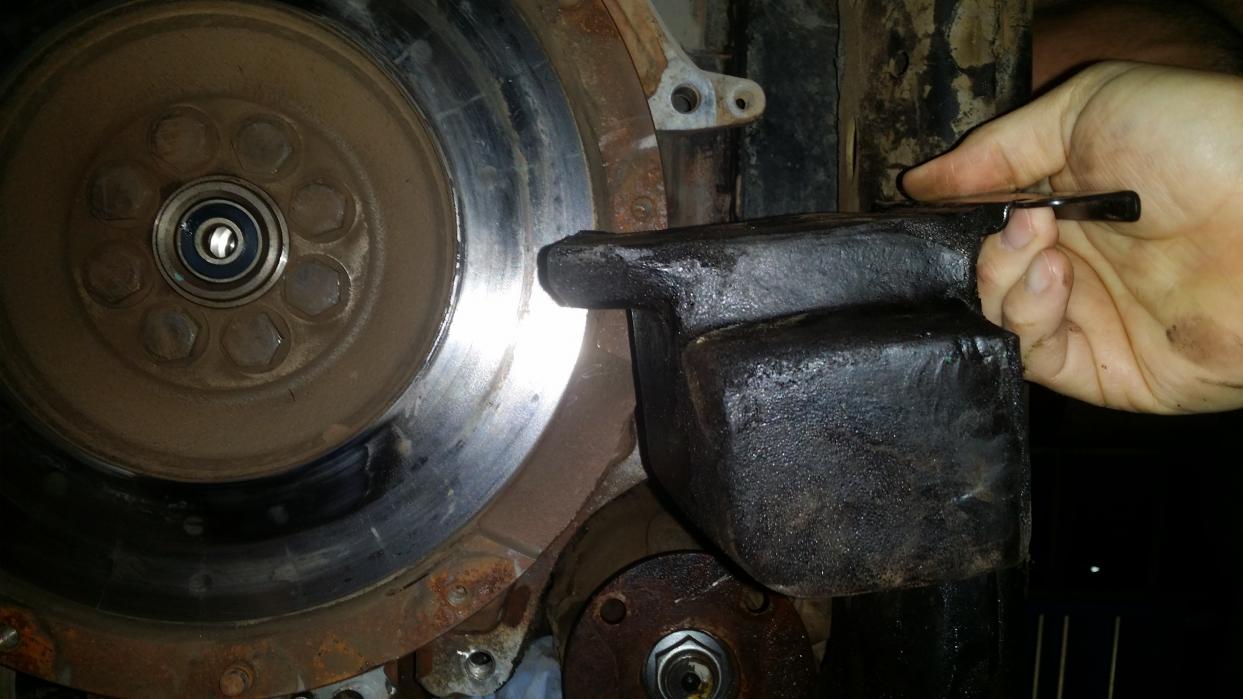

                    Missing part
                    Missing part
                    • #70
                      There is a fair bit of dirt/mud/rust in that clutch assembly. Good luck on getting them to commit to anything by leaving that part out, it wouldn't of helped the situation but I doubt it would of prevented it all. There is a good amount of hot spots on that flywheel too. Don't get your hopes up on them fixing for free, it is a clutch after all.

                      • #71

                          It was tilt trayed to the dealership I bought it from (Carbox) as soon as the knock was discovered. They sent it off to their preferred workshop for motor tear-down and commissioned the report by an expert that stated it was run without oil. (At that point they could have told me to f*ck off and ask for their loan car back as well as charge me for the motor tear down / report).
                          With the Toyota Dealership denying fault, the car then sat at that workshop (where consumer affairs inspected it) until eventually consumer affairs found it my favour.
                          Once Toyota Delearship rebuilt the engine, I should have taken it straight back to Carbox instead of driving it that weekend..... oh well. Carbox gave it back to their preferred workshop who then dropped it to City Toyota for the electrics. City Toyota were given the instruction "make sure we dont see this car again" - they sorted the BCM harness and even replaced an engine mount - when I asked them about the lights being on they didnt know they were to remove that and had it done in 15 minutes.
                          It had been to Robsons Bros once and City Toyota 4 times since......both of which stuffed up in some way shape or form......
                          In regards to the clutch failure - everyone I spoke too (including ####) doubted that this was the actual cause of clutch failure. Once I got underneath the car on the hoist it would have been rather difficult for sand to get in their with the sump in the way.....
                          The part missing is actually catalogued as a noise dampener - it can actually be removed without pulling the gearbox or motor..... nor does it actually seal the clutch from the elements. So where I was hoping I could force the dealership to absorb the labour costs completely I was wrong.....
                          The dealership reduced their labour rate to $100ph, and gave me the clutch kit for around $925, down from $1525 RRP.
                          FYI - for those in WA - Supreme Motor Spares Import Toyota parts and can do the clutch kit for around $600 (trade). It was only half a day after I gave the Toyota Dealership the nod to proceed I discovered this of course !!
