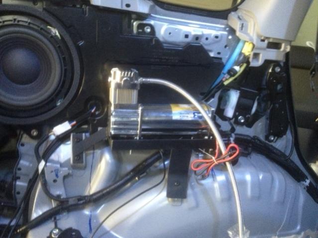

Compressor mounting behind rear left side panel
  • Compressor mounting behind rear left side panel
    I am mounting a compressor behind the side panel on the rear left side because it contains a large void..... seemingly to provde a cup holder mount for the third row left seat! (Might have to sacrifice the cup holder... no big deal , have drawers now not seats!)
    I hope to get the mounting backet made tomorrow then I can run wiring and plumbing etc. My question is: there is a what appears to be a black plastic tank mounted conformally on the side panel and partially behind the outside panel. What is the tank for? Fuel tank expansion? Or maybe it is not a tank???
    Secondly mounted on top of the left rear wheel arch is a sensor. What does it sense?
    My manual searches for the above didn't help much but I didn't find it particularly intuative if you didn't you know what system the part belonged to.
    John

    Guess you have a petrol?

      I have seen those threads. I am using a conventional single cylinder compressor sourced from Air on Board.
      My vehicle is a 2012 GXL Diesel auto.
      The pics in the various threads mentioned all look similar but have different detail.

        I can't remember a tank there which is why I asked whether it was a petrol. Can't see anything in Ages pics either, can you identify the tank in his build shots? ToyoDIY will have arrangements of fuel fillers etc so maybe something there.

          It's in!
Name:	Compressor mount.jpg
          There is a part number on the tank so I will check it on ToyDIY!
            It is a speaker box!!!!!!
