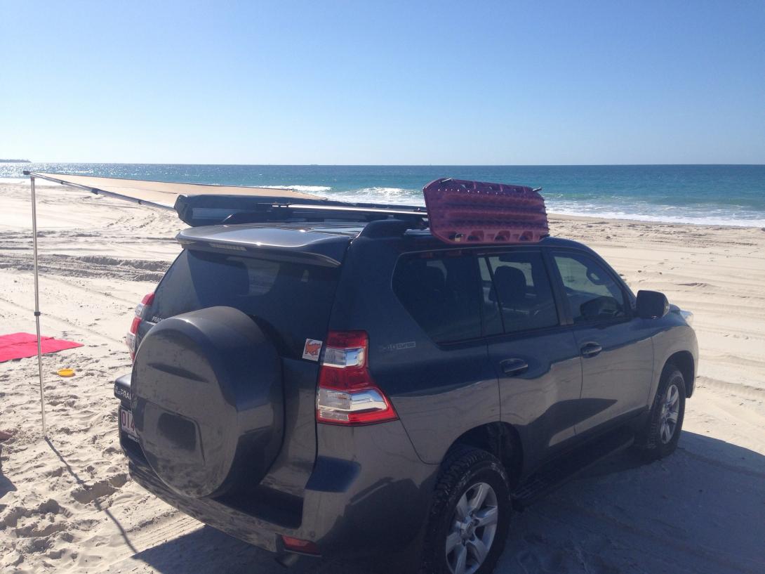

                        • Another run up to Bribie on Sunday, because we can! 24'C and not a cloud in the sky or any wind....gotta love a Queensland winter! And before anyone mentions the fact the awning is shading the car, we had been there for hours and I just couldn't be bothered moving the rig!!!
                          This was followed by a very long clean up today!
